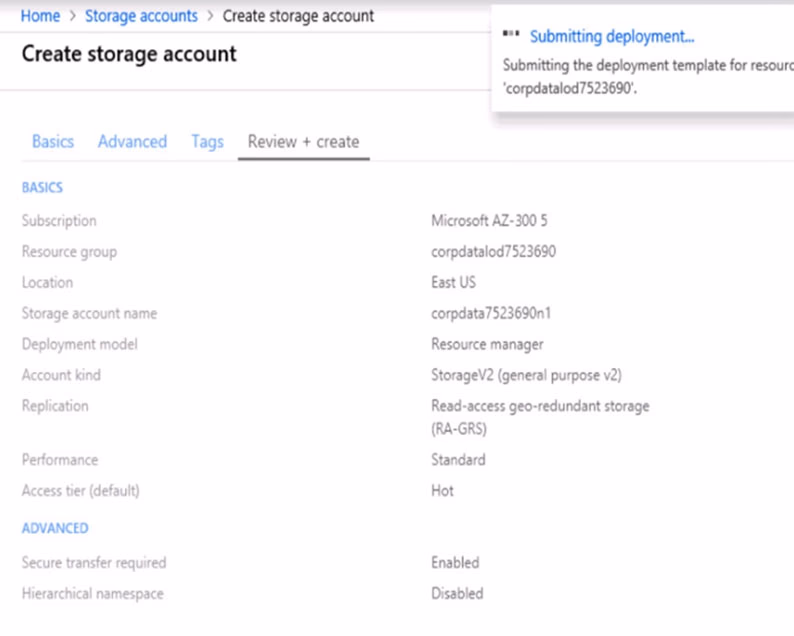

You plan to store media files in the corpdata7523690n1 storage account.
You need to configure the storage account to store the media files. The solution must ensure that only users who have access keys can download the media files and that the files are accessible only over HTTPS.
See solution below.
We should create an Azure file share.
Step 1: In the Azure portal, select All services. In the list of resources, type Storage Accounts. As you begin typing, the list filters based on your input. Select
Storage Accounts.
On the Storage Accounts window that appears.
Step 2: Locate the corpdata7523690n1 storage account.

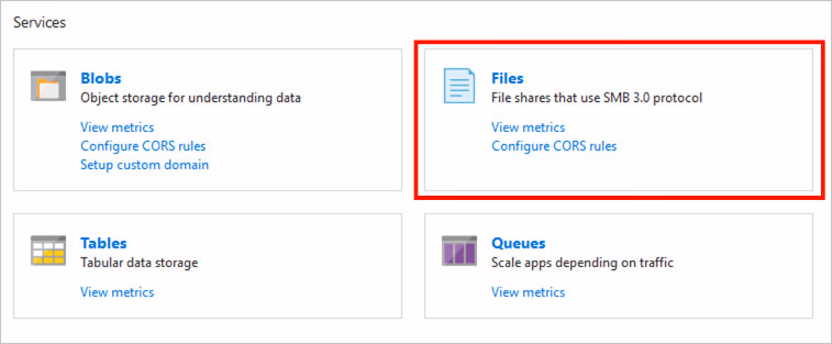

Step 3: On the storage account page, in the Services section, select Files.
Exam AZ-303 Question 197
Step 4: On the menu at the top of the File service page, click + File share. The New file share page drops down.
Step 5: In Name type myshare. Click OK to create the Azure file share.

Blob storage should be used instead as one of requirement is media files can only be accessible via HTTPS. Files storage doesn't support HTTP/S protocol for file access.

It should be blob service, not file service. Blobs are recommended for media files and accessed via HTTP(s), while file share is accessed via SMB protocol.

Azure Files use SMB v3.0, via port 445. So, the solution would be to go for a Blob storage.
