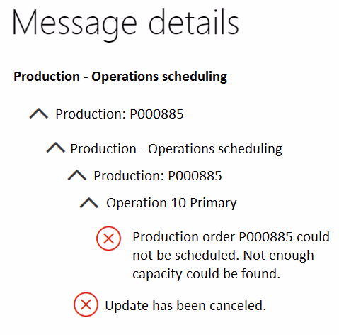

You are the production planner for a manufacturing company.
After running operations scheduling for a production order, the following error message displays:
Exam MB-320 Question 63
You need to identify the cause of the error.
Which two actions should you perform? Each correct answer presents part of the solution.
Correct Answer: BD
To identify the cause of the error indicating that there is not enough capacity for production order P000885, you should first review the calendar for the resource to check if it is expired. If the resource's calendar is expired, it would explain the scheduling failure. Additionally, you should review the resource group assigned to Operation 10. Check if there is a calendar assigned to the resource group and whether that calendar is expired. Expired or missing calendars for the resource group could also cause issues with capacity scheduling. This approach ensures that you verify both individual resources and the resource group as part of your troubleshooting.

Operations scheduling uses the resource group - unless a single resource is specifically is added to the route operation

I would go to AD, as the error is for Operations scheduling no resources are involved yet

For operations scheduling you can connect an operation to either a resource or a resource group. So you must review both resource and resource group for a work calendar with open working times.

So it should be BD https://docs.microsoft.com/en-us/dynamics365/supply-chain/production-control/operations-scheduling

>> The sum of available capacity on the resources that are involved determines the capacity for the resource group. Probably I was wrong - BC is correct

B is correct if you know the calendar assigned to the resource. C is correct as per total capacity on resources. A is incorrect because it doesn't cover the resource. D is incorrect because on this screen we are looking at a production order not the route in general: however, this too can be an issue I believe. The provide answer of BC is probably correct.
