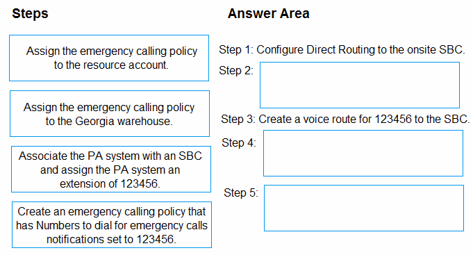

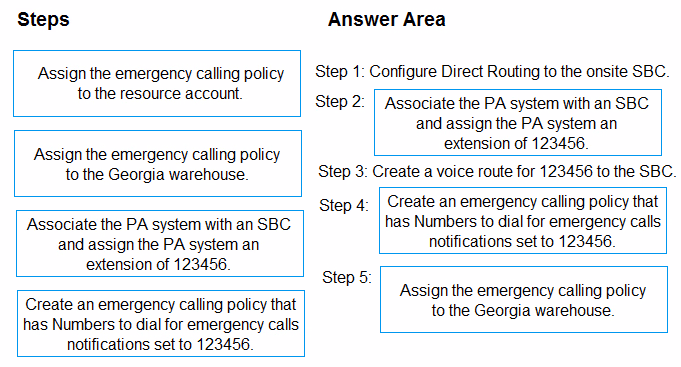

You are replacing the on-site PBX at the Georgia warehouse with Teams.
You need to maintain the functionality of the PBX after migrating to Teams.
Which sequence of steps should you perform? To answer, drag the appropriate steps to the correct locations. Each step may be used once, more than once, or not at all. You may need to drag the split bar between panes or scroll to view content.

https://docs.microsoft.com/en-us/microsoftteams/manage-emergency-calling-policies
Stove1
Jan 6, 2022
Answer is correct
