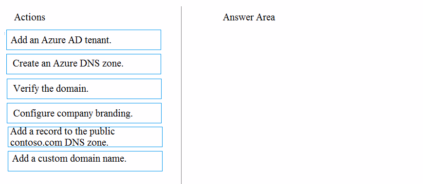

You have an Azure Active Directory (Azure AD) tenant that has the initial domain name.
You have a domain name of contoso.com registered at a third-party registrar.
You need to ensure that you can create Azure AD users that have names containing a suffix of @contoso.com.
Which three actions should you perform in sequence? To answer, move the appropriate cmdlets from the list of cmdlets to the answer area and arrange them in the correct order.

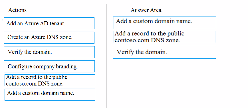

1. Add your custom domain name to Azure AD.
2. Add your DNS information to the domain registrar.
3. Verify your custom domain name.
https://docs.microsoft.com/en-us/azure/active-directory/fundamentals/add-custom-domain

Correct https://docs.microsoft.com/en-us/azure/active-directory/fundamentals/add-custom-domain

Before you can add a custom domain name, create your domain name with a domain registrar. so steps 1 and 2 must be interchanged

Actually, you can first add a custom domain and Azure will tell you what DNS changes you need to do (create a TXT record), save it, then you can do your DNS changes (TXT) and after that, you verify your domain as a final step.

The TXT record string is done at the Add Custom Domain portion. So the answer is correct.

in this case it was already there: "You have a domain name of contoso.com registered at a third-party registrar.". answer is correct.

https://docs.microsoft.com/en-us/azure/active-directory/fundamentals/add-custom-domain Answer given is right
