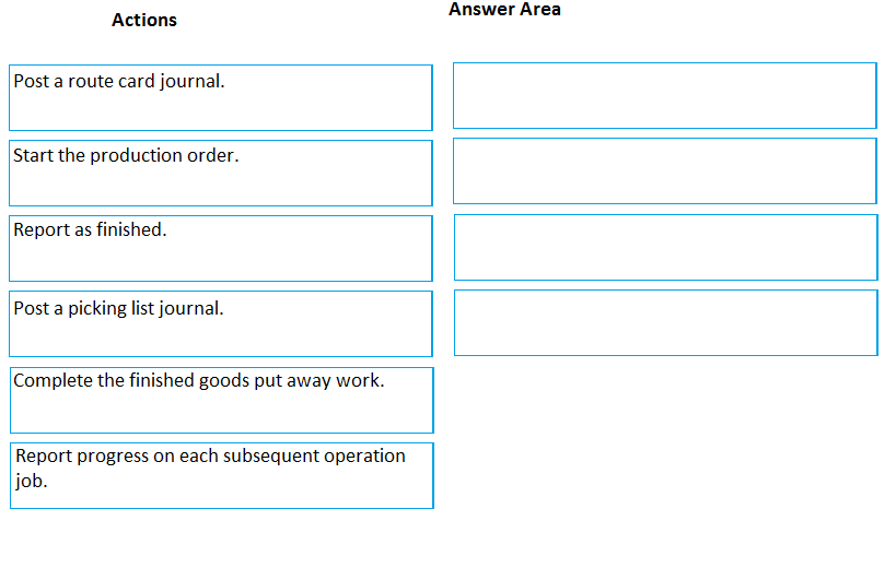

A company uses warehouse management and manufacturing execution to process their production orders.
You configure the manufacturing execution production order defaults to always consume Bill of materials (BOM) components when an operation step is completed in the job registration terminal. You create a production order. The order is in released status.
You need to process this order all the way through to end status.
Which four actions should you perform in sequence? To answer, check the appropriate actions to the answer area and arrange them in the correct order.

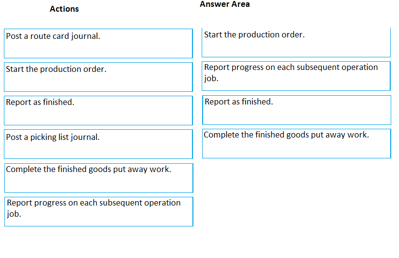

ArieV
Jul 7, 2021
Posting the journals is not needed when defaults are set to always consume when an operation step is completed. So answer is: 2,6,3,5
Pir
May 30, 2021
2, 4, 1, and 3.
Daichisan
Oct 26, 2021
2,6,3,5 should be correct
