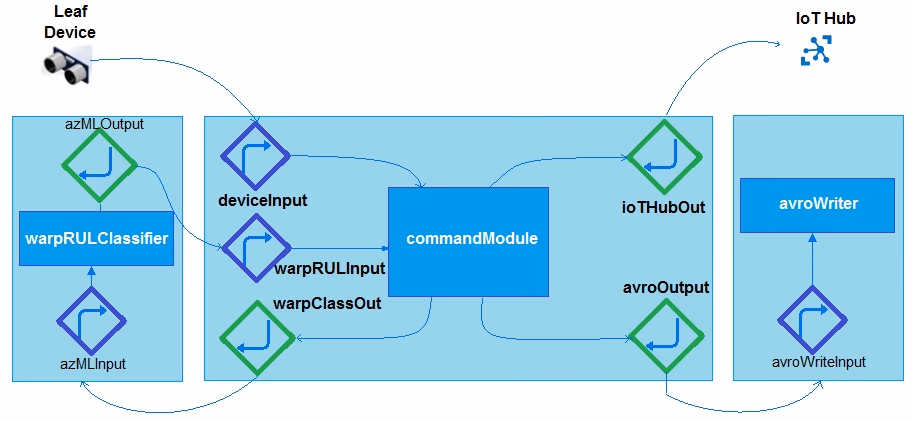

You need to configure Azure IoT Edge module routing to ensure that modules route traffic as shown in the following exhibit.
Exam AZ-220 Question 67

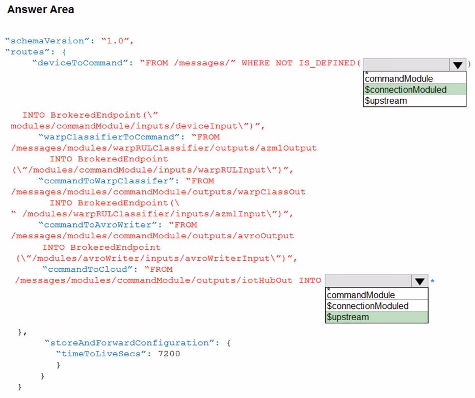

How should you complete the IoT Edge module routes? To answer, select the appropriate options in the answer area.
Box 1: $connectionModuled -
Add a route that tells the edge hub to route any message received by the IoT Edge device that was not sent by an IoT Edge module.
Box 2: $upstream -
Send messages to $upstream, which passes the messages to the connected IoT Hub.
https://docs.microsoft.com/en-us/azure/iot-edge/tutorial-machine-learning-edge-06-custom-modules
d0bermannn
Dec 31, 2021
Provided answer is correct, but in question there is some typo must be connectionModuleID not connectionModuled
