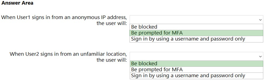

You have an Azure Active Directory (Azure AD) tenant that contains the users shown in the following table.
You create and enforce an Azure AD Identity Protection sign-in risk policy that has the following settings:
✑ Assignments: Include Group1, exclude Group2
✑ Conditions: Sign-in risk level: Low and above
✑ Access: Allow access, Require multi-factor authentication
You need to identify what occurs when the users sign in to Azure AD.
What should you identify for each user? To answer, select the appropriate options in the answer area.

User1 - is excluded but user1 MFA is Enabled Exclusion will take precedence. Ans: MFA will be prompted User2 - is include and user meet the above threshold for sign-in risk level: low and above therefor user account will be blocked. Note: If you target this policy to a user that hasn't registered for MFA. Their access will be blocked Ans: Be blocked

1. user 1 will be prompted for sign-up MFA ( exclusion is applied) 2. user 2 will be applied policy. however, since user2 MFA is disabled hw will not be able login and will be blocked. a user should prior sign-up MFA to act conditional access policy.

1. Be prompted for MFA 2. Be blocked https://learn.microsoft.com/en-us/azure/active-directory/identity-protection/howto-identity-protection-configure-risk-policies#risk-remediation Users must register for Azure AD MFA before they face a situation requiring remediation. Users not registered are blocked and require administrator intervention.
