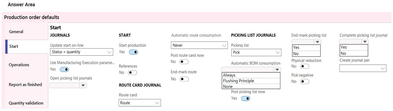

You need to modify the production order defaults for the manufacturing execution production order Start process.

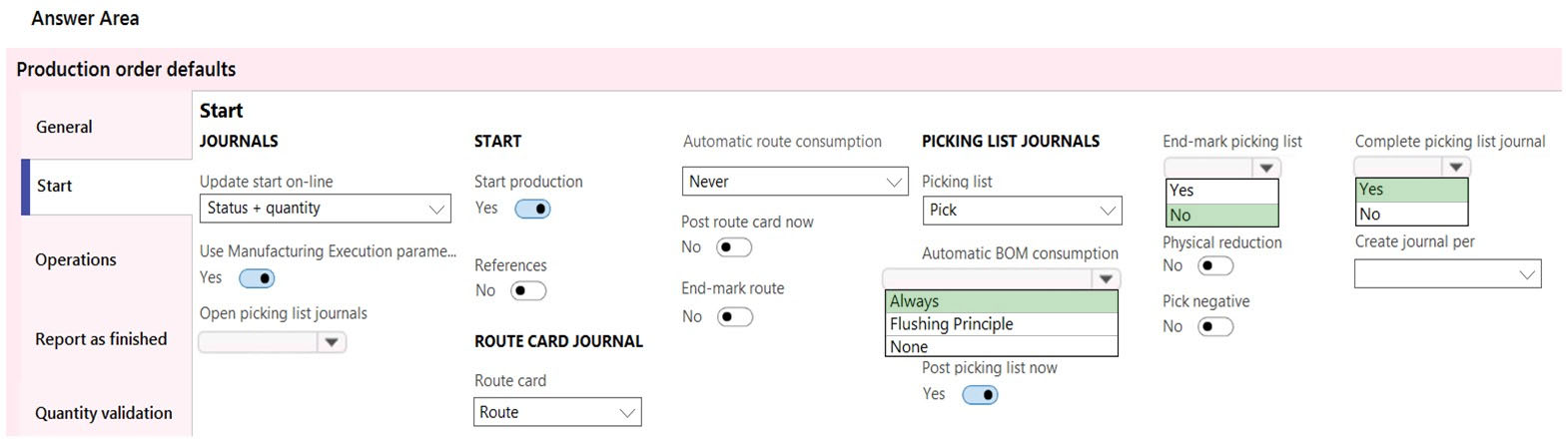

It appears this is setting up plastic manufacturing but it is not clear from the question. We are posting material flushing at start (auto BOM always), allowing for additional picks (end-mark picking list is no) and completing the picking journal for flushed items for accuracy (complete picking list yes). Answer appears correct for plastic manufacturing but not motorcycle. https://docs.microsoft.com/en-us/dynamicsax-2012/appuser-itpro/key-tasks-set-up-manufacturing-execution#set-up-production-parameters--start-parameters

What requirement implies No for End option?

And it's not clear what part we are talking about: Post actual material consumption after production is finished. - for one of the option
