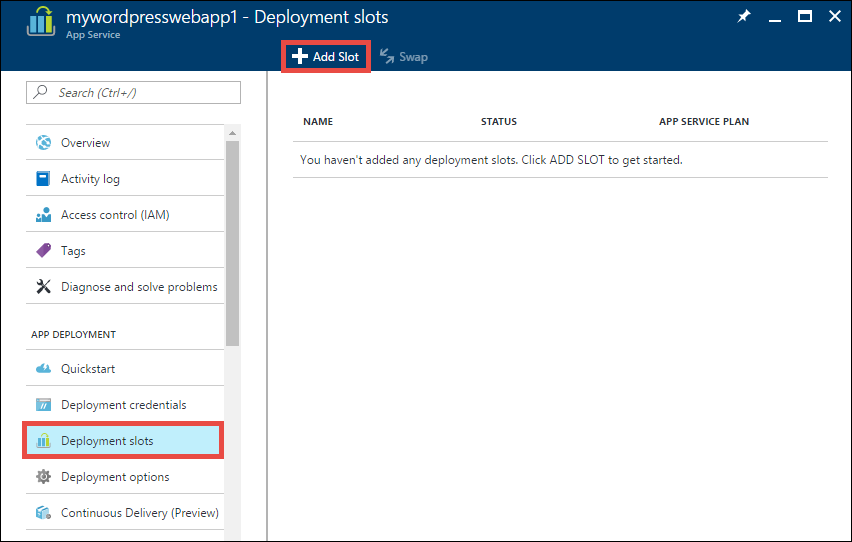

Step 1:
Locate and open the corplod10217507n4 web app.
1. In the Azure portal, on the left navigation panel, click Azure Active Directory.
2. In the Azure Active Directory blade, click Enterprise applications.
Step 2:
Open your app's resource blade and Choose the Deployment slots option, then click Add Slot.
Step 3:
In the Add a slot blade, give the slot a name, and select whether to clone app configuration from another existing deployment slot. Click the check mark to continue.
The first time you add a slot, you only have two choices: clone configuration from the default slot in production or not at all.
https://docs.microsoft.com/en-us/azure/app-service/web-sites-staged-publishing
Anonymous
Jan 23, 2021
Not sure how the provided answer is correct... Azure Portal App Service Select Application corplod10217507n4 (or create a new app) Navigate to Deployment Slots Add Deployment Slot (eg named Staging) and save From Deployment Slot, select corplod10217507n4-Staging deployment slot Navigate to Settings | Configuration Select the General Settings tab Enable the Deployment Slot | 'Auto Swap Enabled' Save
Jamesat
Jan 28, 2021
Yep need that last part to satisfy the question.
oshoparsi
Feb 4, 2021
correct! we need to configure auto swap. https://docs.microsoft.com/en-us/azure/app-service/deploy-staging-slots#configure-auto-swap
