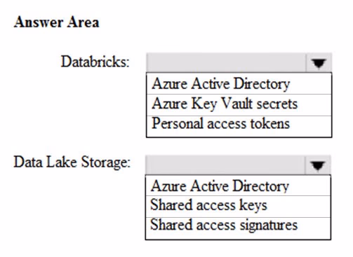

You use Azure Data Lake Storage Gen2 to store data that data scientists and data engineers will query by using Azure Databricks interactive notebooks. The folders in Data Lake Storage will be secured, and users will have access only to the folders that relate to the projects on which they work.
You need to recommend which authentication methods to use for Databricks and Data Lake Storage to provide the users with the appropriate access. The solution must minimize administrative effort and development effort.
Which authentication method should you recommend for each Azure service? To answer, select the appropriate options in the answer area.
Exam DP-201 Question 132

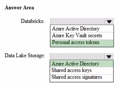

Databricks: Personal access tokens
To authenticate and access Databricks REST APIs, you use personal access tokens. Tokens are similar to passwords; you should treat them with care. Tokens expire and can be revoked.
Data Lake Storage: Azure Active Directory
Azure Data Lake Storage Gen1 uses Azure Active Directory for authentication.
https://docs.azuredatabricks.net/dev-tools/api/latest/authentication.html https://docs.microsoft.com/en-us/azure/data-lake-store/data-lakes-store-authentication-using-azure-active-directory

Answer is Correct https://docs.databricks.com/dev-tools/api/latest/authentication.html https://docs.microsoft.com/en-us/azure/databricks/data/data-sources/azure/azure-datalake-gen2 https://docs.microsoft.com/en-us/azure/databricks/data/data-sources/azure/azure-datalake-gen2#adls2-aad-credentials

All the answers above are wrong. The correct answers are: 1.Databricks: Azure Active Directory 2.Data Lake Storage: Azure Active Directory 1. There is no mention of connecting with the Databricks API, instead the descriptions days that users will connect to ADLS using Interactive Notebooks. For that they will have to log in to Databricks itself, which will be done with their AD accounts. 2. Shared access signature or shared access keys do not use ACLs, but RBAC, and are applied on container or storage account level, NOT on directory or file level. I quote from https://docs.microsoft.com/nl-nl/azure/storage/blobs/data-lake-storage-access-control "ACLs apply only to security principals in the same tenant, and they don't apply to users who use Shared Key or shared access signature (SAS) token authentication. That's because no identity is associated with the caller and therefore security principal permission-based authorization cannot be performed."

1.Databricks: Azure Active Directory (minimize administrative effort) 2.Data Lake Storage: Azure Active Directory
