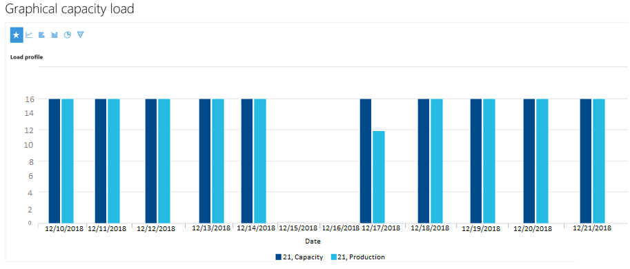

You are the production scheduler for a manufacturing company. You have run the Resource Group Capacity report as shown in the Resource Group 21 Capacity exhibit. (Click the Resource Group 21 Capacity tab).

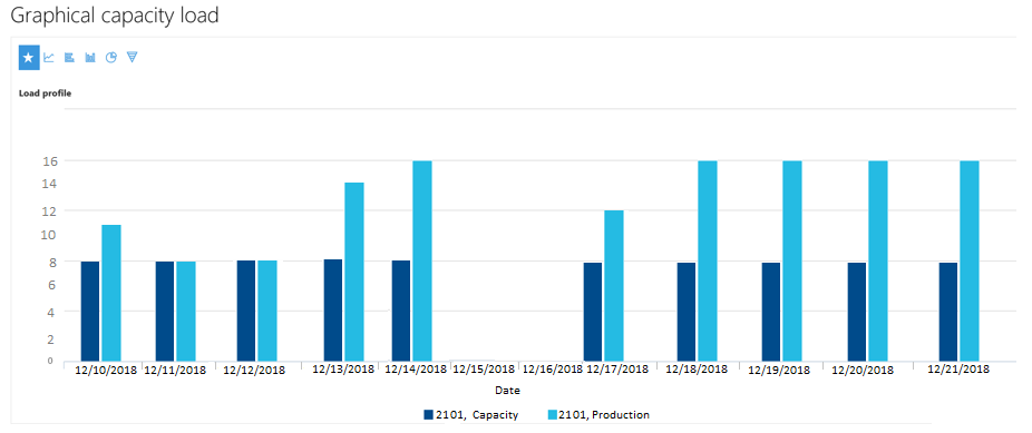

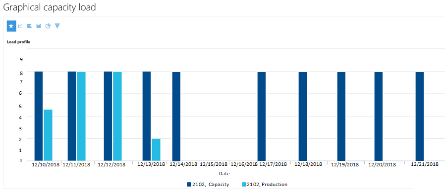

After reviewing that report, you run Resource Capacity reports as shown in the Resource 2101 and 2102 Capacity exhibits. (Click the 2101 Capacity and 2102

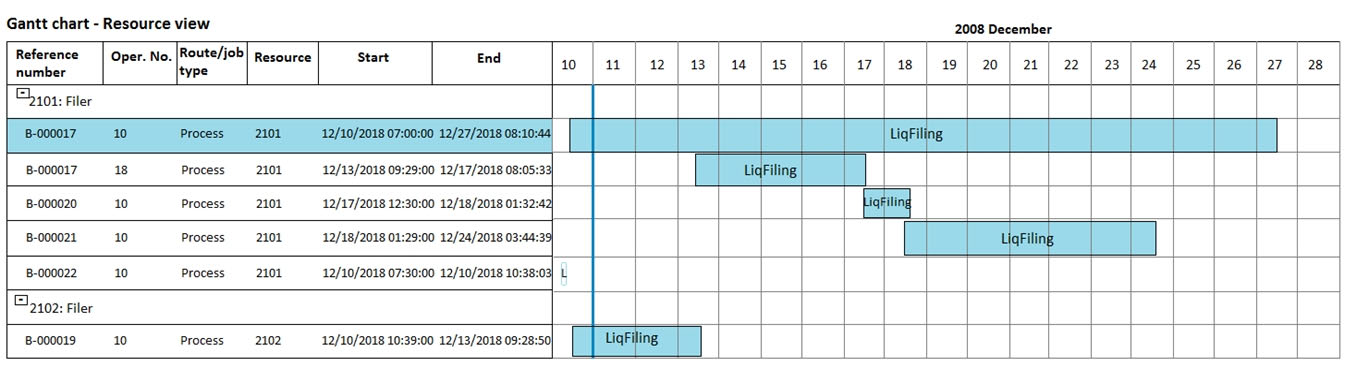

You run the Gantt chart report as shown in the Gantt exhibit to determine the production orders scheduled on the resources. (Click the Gantt tab.)

Yes, yes, no. 2101 is over booked as per graph. So how 2102 is being resolved?

Yes, Yes, No because no item B-000018 exists.

I don't see ...00018 order in the list. But anyway I believe it must be No in the last option?

Yes yes no. 1. Overbooked = Yes (2101 is overbooked) 2. Potential Solution where neither are overbooked = Yes (Resource group chart shows combined capacity and load; Combined capacity is not over loaded; Therefore a solution is possible). 3. No (Multiple orders will need to be reallocated to resource 2102, in order to balance)

1, Overbooked=Yes 2, Solution where neither resource is overbooked=No (if there is no problem, no solution required) 3, As we don't know what B-000018 has in terms of capacity =No
