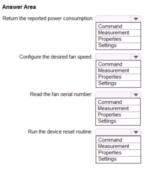

AZ-220 Exam - Question 27
You have an Azure IoT Central application that has a custom device template.
You need to configure the device template to support the following activities:
✑ Return the reported power consumption.
✑ Configure the desired fan speed.
✑ Run the device reset routine.
✑ Read the fan serial number.
Which option should you use for each activity? Each correct answer presents part of the solution.
Exam AZ-220 Question 27

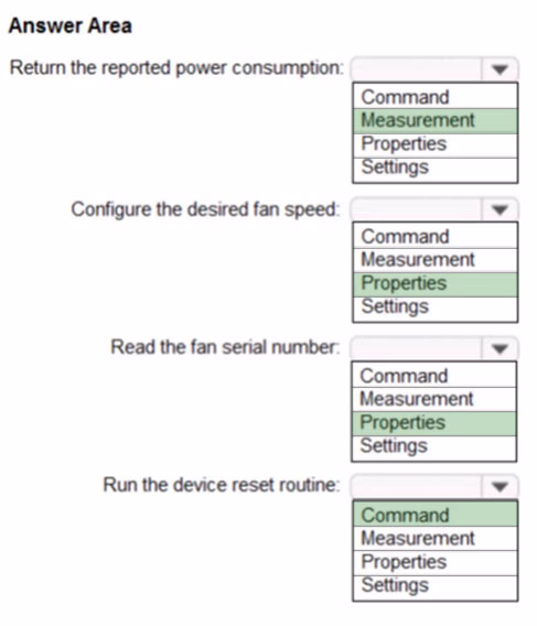

A device template in Azure IoT Central is a blueprint that defines the:
✑ Telemetry a device sends to IoT Central.
✑ Properties a device synchronizes with IoT Central.
✑ Commands that IoT Central calls on a device.
Box 1: Measurement -
Telemetry/measurement is a stream of values sent from the device, typically from a sensor. For example, a sensor might report the ambient temperature.
Box 2: Properties -
The template can provide a writeable fan speed property
Properties represent point-in-time values. For example, a device can use a property to report the target temperature it's trying to reach. You can set writeable properties from IoT Central.
Box 3: Properties -
Box 4: Command -
You can call device commands from IoT Central. Commands optionally pass parameters to the device and receive a response from the device. For example, you can call a command to reboot a device in 10 seconds.
https://docs.microsoft.com/en-us/azure/iot-central/core/howto-set-up-template
Arockia
Nov 8, 2021
The question Options are wrong. The correct answer is: a. Return the reported power consumption --> Telemetry b. Configure the desired fan speed --> Properties c. Read the fan serial number --> Cloud Properties d. Run the device reset routine --> command
dedede
Jun 1, 2021
I am not sure but "Configure the desired fan speed" sounds like "Settings" answer. Am I right?
exam67
Jun 7, 2021
No, because there is no "settings" when it comes to device template "interfaces" https://docs.microsoft.com/en-us/azure/iot-central/core/concepts-device-templates#interfaces
ridhz
Jun 28, 2021
I am not sure but "Run device reset routine" sounds like a "Settings" answer. Am I right?
