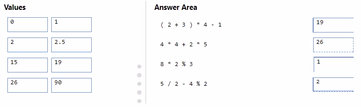

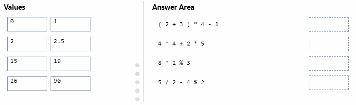

Your instructor asks you to evaluate four arithmetic code segments.
What is the value of each code segment? To answer, drag the appropriate value from the column on the left to its code segment on the right. Each data may be used once, more than once, or not at all. You may need to drag the split bar between panes or scroll to view content.

it should be 2.5 not 2 for the last one
Tybs
Sep 2, 2020
2 is correct. Since the value of 5/2 (2.5) is never stored in a double or float, the result will be rounded down to 2. Try it out with the following code: public static void main(String[] args) { System.out.println(5/2-4%2); }

// Try it! System.out.println((2+3)*4-1); System.out.println(4*4+2*5); System.out.println(8*2%3); System.out.println(5/2-4%2); 19 26 1 2
johnhartman1968
Jan 19, 2021
2 for the last answer. Tested in code. An integer is returned, which drops the .5
