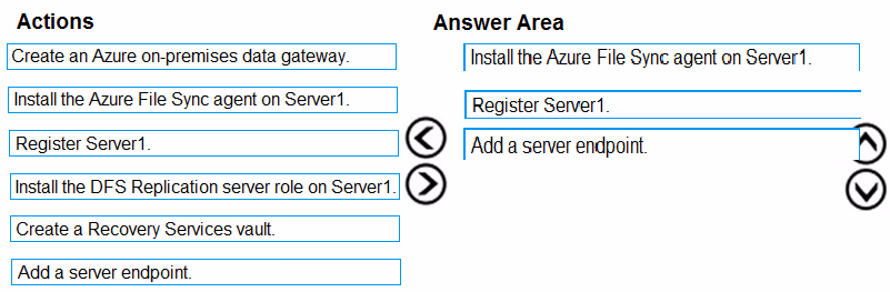

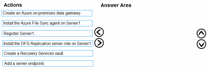

You have an on-premises file server named Server1 that runs Windows Server 2016.
You have an Azure subscription that contains an Azure file share.
You deploy an Azure File Sync Storage Sync Service, and you create a sync group.
You need to synchronize files from Server1 to Azure.
Exam AZ-103 Question 37
Step 1: Install the Azure File Sync agent on Server1
The Azure File Sync agent is a downloadable package that enables Windows Server to be synced with an Azure file share
Step 2: Register Server1.
Register Windows Server with Storage Sync Service
Registering your Windows Server with a Storage Sync Service establishes a trust relationship between your server (or cluster) and the Storage Sync Service.
Step 3: Add a server endpoint -
Create a sync group and a cloud endpoint.
A sync group defines the sync topology for a set of files. Endpoints within a sync group are kept in sync with each other. A sync group must contain one cloud endpoint, which represents an Azure file share and one or more server endpoints. A server endpoint represents a path on registered server.
https://docs.microsoft.com/en-us/azure/storage/files/storage-sync-files-deployment-guide

given answer is correct
Cloudyuga
May 16, 2020
Yes given answer is right . I preformed the lab and checked it..!!
Cloudyuga
May 16, 2020
Install Azure file syn agent (On-prem) register the server using inside Azure file syn agent (on-prem) add server end point (At azure side inside Azure file syn service)

Register server is attaching local server to cloud. Endpont registration is mapping cloud share to local servers for syncing data.

Answer is correct: - Prepare Windows Server to use with Azure File Sync - Deploy the Storage Sync Service - Install the Azure File Sync agent - Register Windows Server with Storage Sync Service - Create a sync group and a cloud endpoint - Create a server endpoint - Configure firewall and virtual network settings - Onboarding with Azure File Sync https://docs.microsoft.com/en-us/azure/storage/file-sync/file-sync-deployment-guide?tabs=azure-portal%2Cproactive-portal
