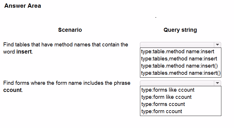

You are using the Metadata search tool in Visual Studio.
You need to select the appropriate query string for various scenarios.
Which query string should you use? To answer, select the appropriate options in the answer area.
Exam MB-500 Question 42

actually is: type:table,method name:insert type:form ccount

that's true, validated

correct

type:table,methodName:insert type:form ccount

type: table,method name:insert type:form ccount is right.

type:table,method name:insert (Not in an option) type:form ccount https://learn.microsoft.com/en-us/dynamics365/fin-ops-core/dev-itpro/dev-tools/metadata-search-visual-studio

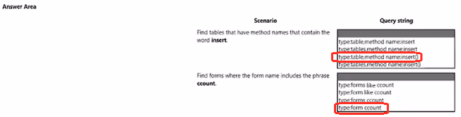

1 - Only 2nd option works 2 - Both 3 & 4 works

the 3rd doesn't work

box 1 write answer type:table,method name:insert and not exists in option box2 type:form ccount

the correct solution type:table,methodname:insert without spaces between method and name

Correct answer: type:table,method name:insert type:form ccount https://learn.microsoft.com/en-us/dynamics365/fin-ops-core/dev-itpro/dev-tools/metadata-search-visual-studio
