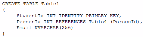

Table1.
Exam AZ-303 Question 62

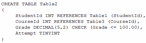

Table2.

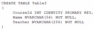

Table3.

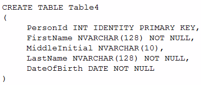

Table4.
You need to identify which table must be created last.
What should you identify?
Table2 should be created last because it contains foreign key references to both Table1 and Table3. For these references to be valid, Table1 and Table3 need to exist before Table2 is created. Table1 references Table4, so Table4 must be created before Table1. Therefore, the order of creation should start with Table4, followed by Table1 and Table3, and finally Table2.

Table2 is the correct answer as it references to Table 1 and Table 3 so these 2 tables should be created first
Rockers
Apr 11, 2021
Correct. Sequence of table creation will be .... Table 4 | Table 1, 3 | Table 2

Table1 references Table4. Therefore Table4 must be created before Table1. Table2 references Table1 and Table3. Therefore Table1 and Table3 must be created before Table2 Answer is B

Yes the answer is correct . . . logically. But because no foreign key constraints are defined as part of the create table means you can create the tables in any order!
