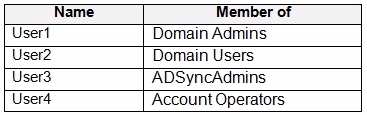

Your network contains an on-premises Active Directory domain named contoso.com. The domain contains the users shown in the following table.
Exam AZ-303 Question 51
You plan to install Azure AD Connect and enable SSO.
You need to specify which user to use to enable SSO. The solution must use the principle of least privilege.
Which user should you specify?
To enable Single Sign-On (SSO) using Azure AD Connect while adhering to the principle of least privilege, you should use a user who is a member of ADSyncAdmins. According to best practices, the user account required for enabling SSO needs administrative permissions related to directory synchronization but does not necessarily need to have full domain administrator privileges. Thus, User3, being a member of ADSyncAdmins, is the most appropriate choice, as this role is specifically tailored for managing directory synchronization tasks without granting excessive permissions.

It's correct. Set up domain administrator credentials: You need to have domain administrator credentials for each Active Directory forest that: You synchronize to Azure AD through Azure AD Connect. Contains users you want to enable for Seamless SSO.

You are wrong, A is the correct answer: https://docs.microsoft.com/en-us/azure/active-directory/hybrid/how-to-connect-sso-quick-start Scroll down til you see or search for *Set up domain administrator credentials

according to the link provided by qerem, answer is C , "Domain Admins"

According to this document the answer is clearly C, domain admins

According to your link ; "The domain administrator credentials are not stored in Azure AD Connect or in Azure AD. They're used only to enable the feature." (feature here means Enabling SSO) So its domain admins

answer should be domain user. As of build 1.4.18.0, you can't use an enterprise admin or domain admin account as the Azure AD DS connector account. When you select Use existing account, if you try to enter an enterprise admin account or a domain admin account, you see the following error: "Using an Enterprise or Domain administrator account for your AD forest account is not allowed. Let Azure AD Connect create the account for you or specify a synchronization account with the correct permissions."

But this is not about additional user. You are the 1st user. The other two links say you need to be domain admin. Set up domain administrator credentials: You need to have domain administrator credentials for each Active Directory forest that: From the how-to-connect-sso-quick-start link: You synchronize to Azure AD through Azure AD Connect. Contains users you want to enable for Seamless SSO.

it should be B. domain user. the question asks "You need to specify which user to use to enable SSO", not the user installing AD connect which should be Enterprise Admin. As of build 1.4.18.0, you can't use an enterprise admin or domain admin account as the Azure AD DS connector account. When you select Use existing account, if you try to enter an enterprise admin account or a domain admin account, you see the following error: "Using an Enterprise or Domain administrator account for your AD forest account is not allowed. Let Azure AD Connect create the account for you or specify a synchronization account with the correct permissions."

But the question is not about the user required for sync, but which user is required to 'enable SSO'. And THAT must be Domain Admin (or Enterprise Admin in a multi-domain forest).

Answer is C User1 is a domain admin. You need to have domain administrator credentials for each Active Directory forest that: · You synchronize to Azure AD through Azure AD Connect. · Contains users you want to enable for Seamless SSO. https://docs.microsoft.com/en-us/azure/active-directory/hybrid/how-to-connect-sso-quick-start

The answer is "C"/User 1. If you follow the link, it states: Continue through the wizard until you get to the Enable single sign on page. Provide domain administrator credentials for each Active Directory forest that: You synchronize to Azure AD through Azure AD Connect. Contains users you want to enable for Seamless SSO. After completion of the wizard, Seamless SSO is enabled on your tenant.

Provide domain administrator credentials for each Active Directory forest that: You synchronize to Azure AD through Azure AD Connect. Contains users you want to enable for Seamless SSO. The domain administrator credentials are not stored in Azure AD Connect or in Azure AD. They're used only to enable the feature.
