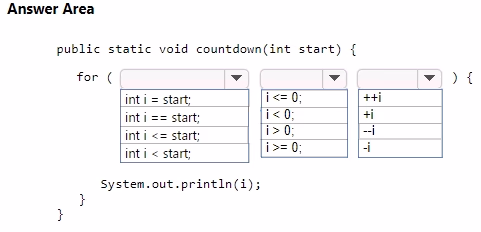

You are writing a Java method named countdown.
The method must meet the following requirements:
✑ Accept an int parameter named start
✑ Display all numbers from start to zero in decrements of one
How should you complete the code? To answer, select the appropriate code segments in the answer area.
Exam 98-388 Question 31

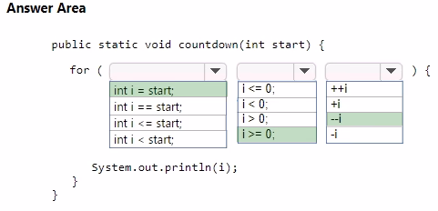

correct!
alejandro355416
Apr 28, 2021
>0 for second option
Qudaci
Sep 14, 2021
for it to be 'from start to zero', it needs to be >= or the zero will be skipped. predecrementation takes no effect here
VishalPt
Aug 11, 2021
0>=i public class Test{ public static void main(String []args){ for (int i=5;i>=0;--i){ System.out.println("Value i :" + (i)); } } }
