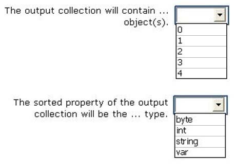

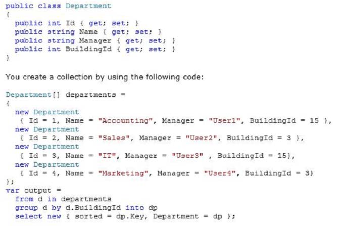

You define a class by using the following code:
To answer, complete each statement according to the information presented in the code.

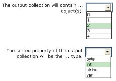

supersunny
Jul 24, 2019
2 objects, int type
GiantMike70_483
Dec 23, 2019
Agree, validated this in visual studio using intellisense.
HgstExam
Sep 6, 2020
Correct, 2 Objects of Key int type, but the last property contains a list of the grouping.
FinderZ
Jan 7, 2021
A. 2 B. Int Proof: https://dotnetfiddle.net/KF1DDI
