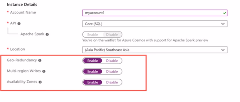

You can enable Availability Zones by using Azure portal when creating an Azure Cosmos account.
You can enable Availability Zones by using Azure portal.
Step 1: enable the Geo-redundancy, Multi-region Writes
1. In Azure Portal search for and select Azure Cosmos DB.
2. Locate the Cosmos DB database named cosmos10543936
3. Access the properties for cosmos10543936
4. enable the Geo-redundancy, Multi-region Writes.

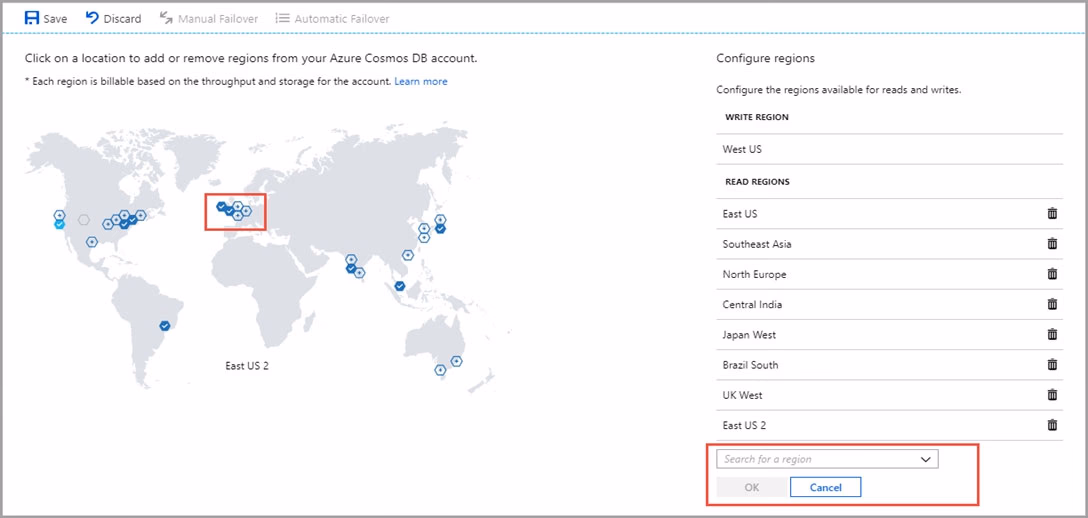

Step 2: Add region from your database account
1. In to Azure portal, go to your Azure Cosmos account, and open the Replicate data globally menu.
2. To add regions, select the hexagons on the map with the + label that corresponds to your desired region(s). Alternatively, to add a region, select the + Add region option and choose a region from the drop-down menu.
Add: West US region -
Exam DP-200 Question 41
3. To save your changes, select OK.

There is no need for multi-region writes only geo-redundancy. See https://docs.microsoft.com/en-us/azure/azure-sql/database/active-geo-replication-overview You can create the secondary across the country where it would have low latency for someone nearby and it would be readable.

You're right. Sorry about that. In this link (https://docs.microsoft.com/en-us/azure/cosmos-db/high-availability) look at the section on multi-region accounts with a single write region. There is no need given the stated objectives to enable multi-region writes. Thanks for the catch.

I am also now wondering why they suggested using the availability zones feature. The way the question is worded, "ensure that users in the West region can read..." makes me wonder if "ensure" is the key word here and that's why they are also enabling the availability zones which I would not have done if I was only interested in saving money.
cadio30
May 7, 2021
It make sense to enable the "Availability Zones" as part of the requirement since there is a chance the replicated server could go down.

The question specifies "users in the West US region can READ data". Geo redundancy should cut it and Multi region writes are unnecessary.
