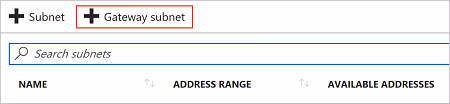

On the Subnets page, click +Gateway subnet at the top to open the Add subnet page.

You should add regular subnet, not a gatway subnet. App gateway requires an empty, regular subnet

Need 2 subnets. one gateway subnet for AG and one subnet for backend. https://docs.microsoft.com/en-us/azure/application-gateway/quick-create-portal

Question is about "Application Gateway", not "VPN Gateway" ! So you just have to create a simple subnet in the existing VNet

Tried in lab. Can’t be a gateway subnet. Has to be empty regular subnet or a subnet that only contains application gateways.

Needs to create empty subnet in Vnet . Gateway subnet would not require.

You need one subnet for the application gateway and one subnet for the virtual machines (backend). Subnet0 is available for the the virtual machines (backend). You need to create a normal subnet for the application gateway. see: https://docs.microsoft.com/en-us/azure/application-gateway/quick-create-portal

The answer is correct. The subnet must be named 'GatewaySubnet' in order for Azure to deploy the gateway resources. You can't specify a different subnet to deploy the gateway resources to. If you don't have a subnet named 'GatewaySubnet', when you create your VPN gateway, it will fail. https://github.com/MicrosoftDocs/azure-docs/blob/master/includes/vpn-gateway-about-gwsubnet-include.md#:~:text=The%20subnet%20must%20be%20named,VPN%20gateway%2C%20it%20will%20fail.

Done this in the lab. The key is in the VNet, you must ensure there is a subnet called "appgateway". If you don't have such a subnet, it cannot be used during the creation of the application gateway. Ensure the region is the same as the vNet if not it will also not show.

Sorry just need to be empty name does not matter.

Exam topics answer instructions are incorrect. We just need to create one Subnet for AG and one Subnet for Backend pool, and configure AG within the vNet.
