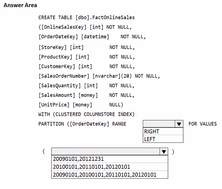

You have an enterprise data warehouse in Azure Synapse Analytics that contains a table named FactOnlineSales. The table contains data from the start of 2009 to the end of 2012.
You need to improve the performance of queries against FactOnlineSales by using table partitions. The solution must meet the following requirements:
✑ Create four partitions based on the order date.
✑ Ensure that each partition contains all the orders placed during a given calendar year.
How should you complete the T-SQL command? To answer, select the appropriate options in the answer area.

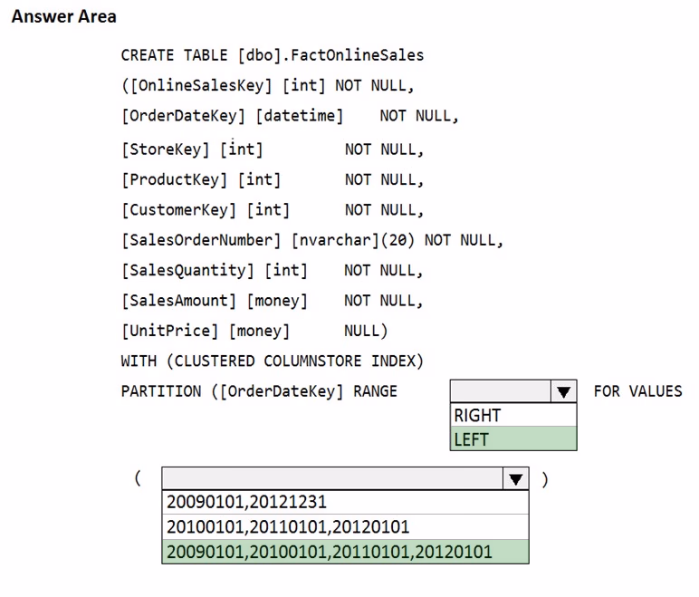

Box 1: LEFT -
RANGE LEFT: Specifies the boundary value belongs to the partition on the left (lower values). The default is LEFT.
Box 2: 20090101, 20100101, 20110101, 20120101
FOR VALUES ( boundary_value [,...n] ) specifies the boundary values for the partition. boundary_value is a constant expression.
https://docs.microsoft.com/en-us/sql/t-sql/statements/create-table-azure-sql-data-warehouse

Akesh
Aug 7, 2021
Considerations Create four partitions based on the order date. Ensure that each partition contains all the orders placed during a given calendar year. If we chose the left option here, data buckets will be like below Partition 1: OrderDateKey <= 20100101 Partition 2: 20100101 < OrderDateKey <= 20110101 Partition 3: 20110101 < OrderDateKey <= 20120101 Partition 4: 20120101 < OrderDateKey The problem here is "Ensure that each partition contains all the orders placed during a given calendar year." will Fail in this case. The OrderDateKey first day of the year ex- 20110101 will be in the partition which contains 2010 dates. If we chose the Right option here, data buckets will be like below Partition 1: OrderDateKey < 20100101 Partition 2: 20100101 <= OrderDateKey < 20110101 Partition 3: 20110101 <= OrderDateKey < 20120101 Partition 4: 20120101 <= OrderDateKey This will "Ensure that each partition contains all the orders placed during a given calendar year." So Option is Right with (20100101,20110101,20120101)

MayankSh
Apr 7, 2021
The second option should be RIGHT, since we need to store calendar data in each partition. Partition 1: col < 20090101 Partition 2: 20090101 <= col < 20100101 Partition 3: 20100101 <= col < 20110101 Partition 4: 20110101 <= col < 20120101 Partition 5: 20120101 <= col
rajneesharora
Apr 29, 2021
This creates 5 partitions and not 4... Question says to create 4 partitions... If we have to create 4 Partitions, it would be "LEFT" and not "RIGHT" Partition 1: 20090101 <= col < 20100101 Partition 2: 20100101 <= col < 20110101 Partition 3: 20110101 <= col < 20120101 Partition 4: 20120101 <= col

JohnCrawford
Apr 9, 2021
Correct answer is Left and the second line in the second area. When you cut a pie in half you have 1 boundary value, but two partitions. Here we want 3 boundary values to create 4 partitions.
111222333
May 12, 2021
Check the link provided in the solution: https://docs.microsoft.com/en-us/sql/t-sql/statements/create-table-azure-sql-data-warehouse?view=aps-pdw-2016-au7 RANGE LEFT: left boundary is exclusive, while the right boundary is inclusive. RANGE RIGHT: left boundary is inclusive, while the right boundary is exclusive. => RANGE RIGHT is certainly the correct option because 01-01-xxxx should be included in the right partition together with all the dates from year xxxx. We just need to play with the date values. Precisely, IMO the correct answer is RANGE RIGHT FOR VALUES (20100101, 20110101, 20120101). - Partition 1: col < 20100101 - Partition 2: 20100101 <= col < 20110101 - Partition 3: 20110101 <= col < 20120101 - Partition 4: 20120101 <= col If the empty partitions are discarded, it could also be RANGE RIGHT FOR VALUES (20090101, 20100101, 20110101, 20120101) because the partition <20090101 is empty. But I think this partition still exists even though it's empty, and the question specifies for 4 partitions. Please provide me evidence if I'm wrong about the existing empty partitions.

AZ20
Jun 5, 2021
Answer should be Right 2010 , 2011, 2012 This ensures all the dates of one calendar year falls in same partiton and 3 boundaries gives 4 partitons
vrmei
Jun 2, 2021
Answer should be RIGHT and 20100101,20110101,20120101 Range Left or Right, both are creating similar partition but there is difference in comparison For example: in this scenario, When you use LEFT and 20100101,20110101,20120101 Partition will be, datecol<=20100101 , datecol>20100101 and datecol<=20110101 , datecol>20110101 and datecol<=20120101, datecol>20120101 But if you use range RIGHT and 20100101,20110101,20120101 Partition will be, datecol<20100101 , datecol>=20100101 and datecol<20110101 , datecol>=20110101 and datecol<20120101, datecol>=20120101 In this example, Range RIGHT will be suitable for calendar comparison Jan 1st to Dec 31st Reference: https://docs.microsoft.com/en-us/sql/t-sql/statements/create-partition-function-transact-sql?view=sql-server-ver15
meswapnilspal
Apr 28, 2021
Correct answer is 'RIGHT' https://docs.microsoft.com/en-us/sql/t-sql/statements/create-table-azure-sql-data-warehouse?view=aps-pdw-2016-au7 (Scroll towards the end) LEFT/RIGHT is confusing, trick to remember is 1. Draw a hyphen among the values 20090101-20100101-20110101-20120101 2. pick one value (say 20100101) 3. Now understand, in which range do we want 20100101 to fall? here we want it in 20100101-20110101. 4. 20110101 is towards its right, Hence 'RIGHT'
Chiranjib
May 13, 2021
The total number of partitions is always the total number of boundary values + 1. As the question talks about four partions, second option should be the right answer.. And as it using is lower value of the right parition, it should be right.

cadio30
Apr 28, 2021
In a range left partition function, all boundary values are upper boundaries, they are the last values in the partitions. If you partition by year, you use December 31st. If you partition by month, you use January 31st, February 28th / 29th, March 31st, April 30th and so on. In a range right partition function, all boundary values are lower boundaries, they are the first values in the partitions. If you partition by year, you use January 1st. If you partition by month, you use January 1st, February 1st, March 1st, April 1st and so on. Reference: https://www.cathrinewilhelmsen.net/table-partitioning-in-sql-server/#:~:text=Range%20Left%20and%20Range%20Right&text=Range%20left%20means%20that%20the,value%20in%20the%20right%20partition.

Marcus1612
Oct 6, 2021
Box 1 = Right, Box 2 = 20090101, 20100101, 20110101, 20120101 In a range left partition function, all boundary values are upper boundaries, they are the last values in the partitions. If you partition by year, you use December 31st. If you partition by month, you use January 31st, February 28th / 29th, March 31st, April 30th and so on. In a range right partition function, all boundary values are lower boundaries, they are the first values in the partitions. If you partition by year, you use January 1st. If you partition by month, you use January 1st, February 1st, March 1st, April 1st and so on:
