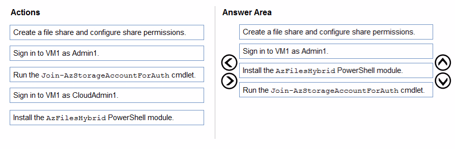

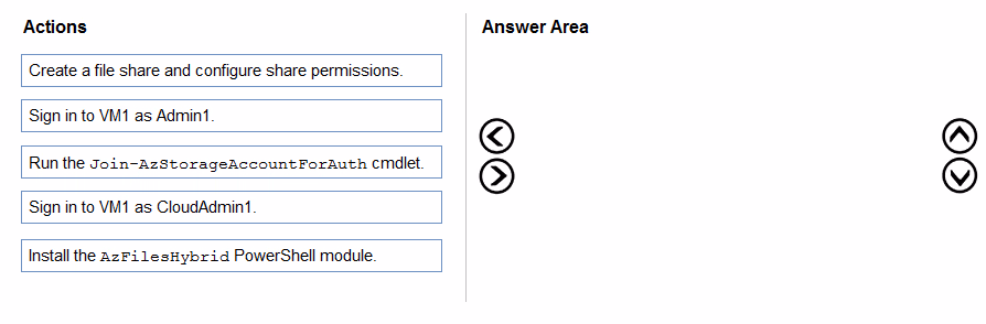

You need to ensure that you can implement user profile shares for the Boston office users. The solution must meet the user profile requirements.

1. Create a file share and configure permissions: Configure permissions for Admin1 - storage account owner or contributor. 2. Sign in to VM1 as Admin1 3. Install PS module 4. Run The Join-Bla cmdlet
constructedrobot
Nov 22, 2022
This is the right way howver, there is no real preference on 1 & 2
Justin0020
May 30, 2022
Correct answer (implemented 2 times last week): Sign in Create a file share Install AZFilesHybrid (needed for last command) Run Join-AzStorageAccountForAuth
thatfuckinguy
Jul 26, 2023
The file share doesn't need to exist yet in order to join the storage account to the domain. CloudAdmin1 can't create an AD object but Admin1 can't create the file share or configure the permissions so, of the steps that are listed here, the correct order is: 1. Sign in as Admin1 2. Install module 3. Join-AzStorageAccountForAuth 4. Create file share and assign permissions The tricky part is that the fourth step isn't actually one step but a series of other steps.
Tijs0289
Sep 20, 2024
According to below Microsoft Doc; it should according to me be: 1. Sign in to VM1 as Admin1. 2. Install AZFilesHybrid PS module 3. Run Join-AzStorageAccount 4. Create file share and configure share permissions https://learn.microsoft.com/en-us/azure/virtual-desktop/fslogix-profile-container-configure-azure-files-active-directory?tabs=adds#configure-session-hosts-to-use-profile-container

You can't configure storage (Run Join-AzStorageAccount) if the storage doesn't exist! 1. Create a file share and configure permissions: Configure permissions for Admin1 - storage account owner or contributor. 2. Sign in to VM1 as Admin1 3. Install PS module 4. Run The Join-Bla cmdlet

https://docs.microsoft.com/en-us/azure/storage/files/storage-files-identity-ad-ds-enable#option-one-recommended-use-azfileshybrid-powershell-module The link describes that an on-prem account sync'd to AD must be used to sign in - CloudAdmin1 is cloud-only. It also states that the on-prem AD account must have Owner or Contributer rights over the Azure storage account - there is no mention of Admin1 being granted those roles unless you count the requirement that Admin1 is to be granted permission to manage Workspaces. So neither is fully correct. On the basis that the account must be a sync'd on-prem account and not a cloud account though it must be Admin1 in my opinion.

CloudAdmin1 has the proper rights to enable AD DS authentication but not enough rights to create an object in AD. Admin 1 has the rights to create the object in AD but not enough right to enable AD DS authetication. Quote from: https://docs.microsoft.com/en-us/azure/storage/files/storage-files-identity-ad-ds-enable "-Install and execute the module in a device that is domain joined to on-premises AD DS with AD DS credentials that have permissions to create a service logon account or a computer account in the target AD. -Run the script using an on-premises AD DS credential that is synced to your Azure AD. The on-premises AD DS credential must have either Owner or Contributor Azure role on the storage account." So the order should be: 1. Sign in to VM1 as Admin1. 2. Install AZFilesHybrid PS module 3. Run Join-AzStorageAccount 4. Create file share and configure share permissions But in order for that to work Admin1 needs to receive the proper rights on the storage account.

@SCT - I do think its sign in, create the file share and configure SMB Share Contributor & SMB Elevated Contributor, then run the AZfilesHybrid ps1, then run the authentication Join of the storage account as a computer account into AD. Think about it, how can you run the Join command if you don't have the file share created in the Azure Storage Account? - can't have a chicken before the egg. ;-)

Sign in to VM1 as Admin1, Install, Run and then Create a file share and configure share permissions

The given answer is correct. I have verified it in the lab.

Provided answer is correct. I found ref link: https://docs.microsoft.com/en-us/azure/storage/files/storage-files-identity-ad-ds-enable#option-one-recommended-use-azfileshybrid-powershell-module

Microsoft Learn Doc details the following FS Logix setup steps in the following order: 1. Create an Azure Files share 2. Install AZFilesHybrid PS Module 3. Sign In as Admin 4. Join AZStorage Account https://learn.microsoft.com/en-us/fslogix/how-to-configure-profile-container-azure-files-active-directory?tabs=adds#configure-session-hosts-to-use-profile-container
