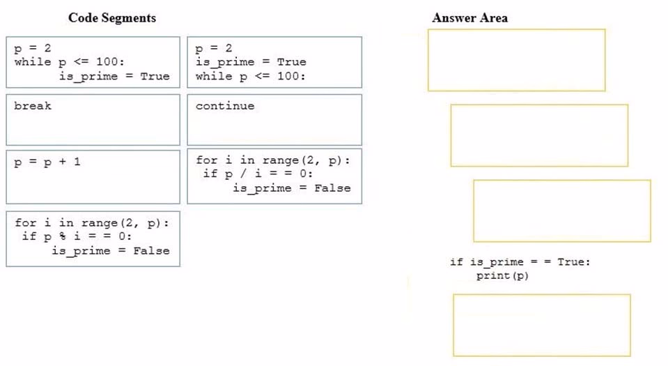

You are building a Python program that displays all of the prime numbers from 2 to 100.
How should you complete the code? To answer, drag the appropriate code segments to the correct location. Each code segment may be used once, more than once, or not at all. You may need to drag the split bar between panes or scroll to view content.

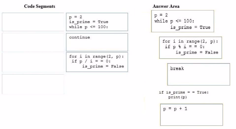

p=2 while p<=100: is_prime=True for i in range(2, p): if p % i == 0: is_prime=False break if is_prime == True: print(p) p=p+1

why is_prime = True it needs to be inside while loop, can someone explain please.
sadako11
Dec 7, 2020
is_prime is what is called a flag. In our program its main purpose is to control which number to print. In our case only prime numbers when is_prime = True. if is_prime==True: print(p) When is_prime is set to False (when a non prime number is found) then the statement if is_prime==True: print(p) is not executed. is_prime must be located inside the while loop to reset its value for each number. If it is located outside the while loop it will not reset and will get stuck with the same value throughout the complete while loop. When the loop finds a non primal number (is_prime==False) is_prime will be stuck with False for the whole while loop and the code if is_prime==True: print(p) will never be executed.

Would you not use 'continue' rather than 'break' so loop can be repeated?

Can someone explain the indentation??
FuzzyDunlop
Jul 7, 2020
The indentation represents the literal indentation you would use when writing the python code. The for loop is within the while loop and the break statement is within the if statement.

p = 2 while p <= 100: is_prime = True for i in range(2, p): if p % i == 0: is_prime = False break if is_prime: print(p) p = p+1
gargaditya
Oct 11, 2020
Perfect answer,be careful with the 'break' statement which breaks the inner for loop the moment a non prime number is detected(after setting is_prime to false) Also note difference between division(/) and remainder after division(%) logic: eg a number like 6 start with 2,test divisibility by 2, 3,4,5 number like 10 start with 2,test divisibility by 2,3,4....9 If anywhere remainder(ie modulo operation->%) is zero ie fully divisble,then mark non prime and break further testing
