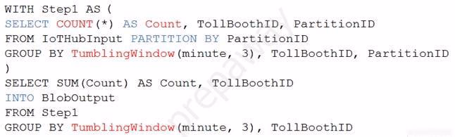

You have the following query for the job.
Exam AZ-220 Question 105
You plan to increase the streaming unit count to 12.
You need to optimize the job to take advantage of the additional streaming units and increase the throughput.
Solution: You change the query to the following.
Does this meet the goal?
The change in the query involves partitioning the input using the 'PARTITION BY' clause. By partitioning the input and then aggregating the results, the workload can be distributed among the increased number of streaming units. The initial setup without partitioning supports a maximum of 6 streaming units. By adding partitioning and creating two steps in the query, the job can utilize the full capacity of 12 streaming units. Therefore, changing the query as described meets the goal of optimizing the job to take advantage of the additional streaming units and increasing the throughput.
kohmaksimkaOption: A
Jan 22, 2022
Yes - https://docs.microsoft.com/en-us/azure/stream-analytics/stream-analytics-parallelization#calculate-the-max-streaming-units-for-a-job Initial query is not partitioned and one step, so max 6 SU as mentioned in question. After altering query, the query now contains two steps. First one partitioned from non-partition input (6 SU) plus the secondary non-partitioned step (+ 6 SU as all non-partitioned steps together can scale up to six streaming units). Total is 12 SU
tita_tovenaar
Jun 29, 2021
answer is Yes. it is. one-step query and is partitioned, so max sku is 96. see table here: https://docs.microsoft.com/en-us/azure/stream-analytics/stream-analytics-parallelization
trickerk
Aug 16, 2021
Answer should be YES. https://docs.microsoft.com/en-us/azure/stream-analytics/stream-analytics-parallelization
Stephan99
May 15, 2021
The input data stream is partitioned by 3. The query contains two steps. The input step is partitioned and the second step is not. The SELECT statement reads from the partitioned input. Result: 24 streaming units: (18 for partitioned steps + 6 for non-partitioned steps) see https://docs.microsoft.com/en-us/azure/stream-analytics/stream-analytics-parallelization
