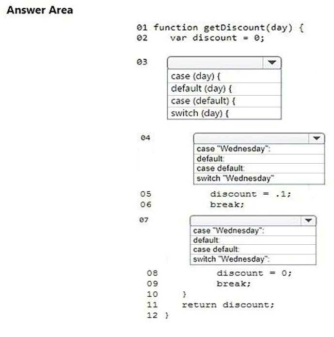

The ABC company offers a mid-week discount of 10% on Wednesdays.
You need to write a JavaScript function that meets the following requirements:
✑ Accepts the day of the week as a string
✑ Returns the appropriate discount
You create the following code. Line numbers are included for reference only.
You must complete the code at lines 03, 04, and 07.
How should you complete the code? To answer, select the appropriate code segments in the answer area.
References: https://www.w3schools.com/jsref/jsref_switch.asp

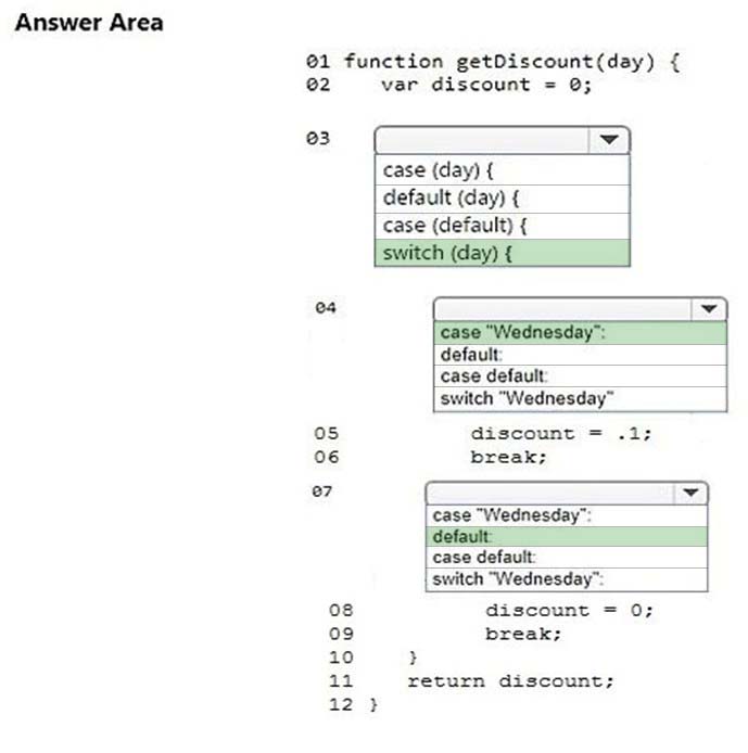

Answer - Correct
