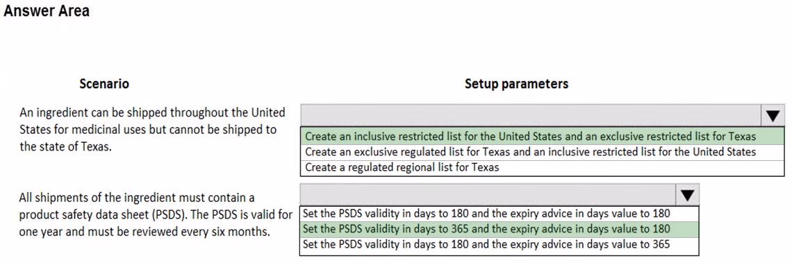

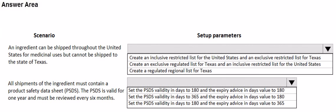

A company produces homeopathic lotions for pain relief and uses Dynamics 365 Supply Chain Management.
Several components used in the production of the pain-relieving lotion and oils have special government-mandated reporting requirements.
You need to ensure the company can provide the appropriate reporting and tracking for these components.
Which parameters should you use? To answer, select the appropriate options in the answer area.

The provided answer is correct. 1. Inclusive list, and then exclusive list to remove Texas from the list of allowed shipping destinations. 2. Validity 365 days, and expiry advice 180 days for someone to review approximately every 6 months.
andreasraithel
Mar 25, 2021
First should b) as reporting depends on regulated products
ElAndo
Apr 11, 2021
No, the answer is correct. If you try the exclusive list first, the system gives you an error message to do the inclusive list first.
