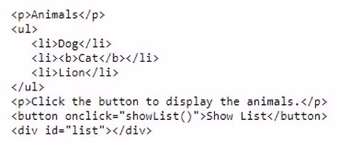

You are designing a web page that contains a list of animals. The web page includes a script that outputs animals from a list.
You create the following HTML to test the script:
Exam 98-382 Question 4
You need to create a function that will display the list of animals, including any formatting, in the div element.

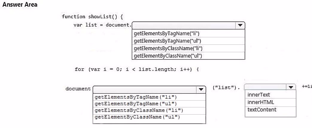

How should you complete the code? To answer, select the appropriate code segments in the answer area.

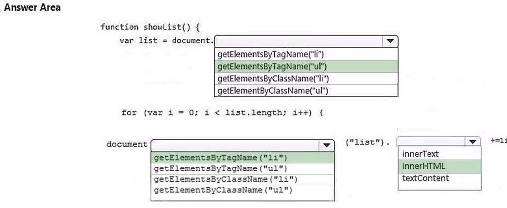

the First answer should be getElementsByTagName("li")
kimdo7
Feb 5, 2021
It is correct because it will give you a list/array of 3 li
PallaviSos
Jul 4, 2021
the answer should be document.getElementById("list").innerHTML +=list[i].innerText;
w35l3y
Jul 4, 2021
getElementsByTagName("li") getElementById innerHTML

function showList() { var list = document.getElementsByTagName("ul"); for (var i = 0; i < list.length; i++) { document.getElementById("list").innerHTML += list[i].innerHTML; }}

function showlist(){ var list = document.getElementsByTagName("ul"); console.log(list); for(var i=0; i<list.length; i++){ document.getElementById("list").innerHTML += list[i].innerHTML + " "; } }
