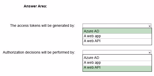

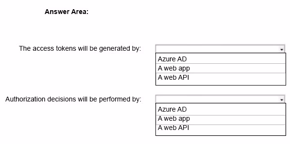

You are designing a software as a service (SaaS) application that will enable Azure Active Directory (Azure AD) users to create and publish surveys. The SaaS application will have a front-end web app and a back-end web API. The web app will rely on the web API to handle updates to customer surveys.
You need to design an authorization flow for the SaaS application. The solution must meet the following requirements:
✑ To access the back-end web API, the web app must authenticate by using OAuth 2 bearer tokens.
✑ The web app must authenticate by using the identities of individual users.
What should you include in the solution? To answer, select the appropriate options in the answer area.

pkum
Jun 9, 2020
Azure AD, Web API are correct answers. Please refer auth workflow diagram here: https://docs.microsoft.com/lb-lu/azure/architecture/multitenant-identity/web-api#register-the-web-api-in-azure-ad
blackalbum
Mar 20, 2020
The answer is correct. Delegated User Identity: The web API makes authorization decisions based on the user identity. https://docs.microsoft.com/lb-lu/azure/architecture/multitenant-identity/web-api

Test_Taker_1
Aug 22, 2020
Says it here plan as day: https://docs.microsoft.com/en-us/azure/architecture/multitenant-identity/web-api Question Requirements: "... must authenticate by using OAuth 2 bearer tokens." "... authenticate by using the identities of individual users." The link above offers 2 flows: 1. Delegated User Identity - this isn't the correct because the one below fits better. 2. Application Identity - Uses OAUTH - Authorization will be performed by Web Application For both cases, it says that a token must come from an identity providers. Therefore Question 1: Azure AD (it's the identity provider) Question 2: "A web app"
