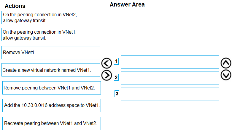

You have an Azure subscription that contains two virtual networks named VNet1 and VNet2. Virtual machines connect to the virtual networks.
The virtual networks have the address spaces and the subnets configured as shown in the following table.
You need to add the address space of 10.33.0.0/16 to VNet1. The solution must ensure that the hosts on VNet1 and VNet2 can communicate.

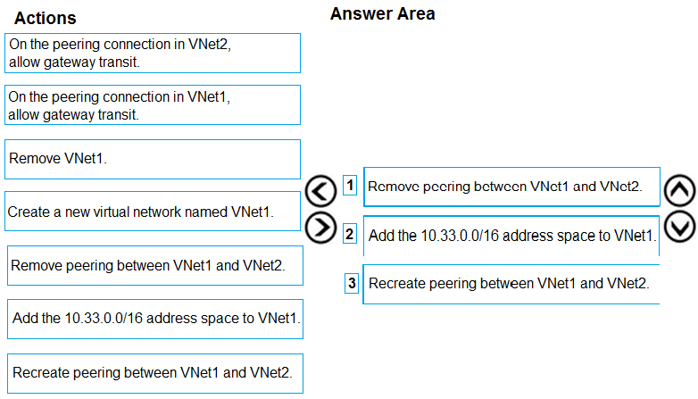

Step 1: Remove peering between Vnet1 and VNet2.
You can't add address ranges to, or delete address ranges from a virtual network's address space once a virtual network is peered with another virtual network.
To add or remove address ranges, delete the peering, add or remove the address ranges, then re-create the peering.
Step 2: Add the 10.44.0.0/16 address space to VNet1.
Step 3: Recreate peering between VNet1 and VNet2
https://docs.microsoft.com/en-us/azure/virtual-network/virtual-network-manage-peering

tested - answers are correct.
wideawake
Jun 30, 2020
answers are ok. You can't add address ranges to or delete address ranges from a virtual network's address space once a virtual network is peered with another virtual network
lavermil
Jul 13, 2020
The answer is correct assuming there was an existing VNET Peering connection between the two VNETs. I might be blind but I don't see one mentioned in the text. No other answers make sense either so sometimes you have to go with an assumption you hope is right. :(
Xquisite
Jul 28, 2020
I believe the table in the question indicates that a peering already exists under the peering column.
Shades
Jul 5, 2020
The given answer is correct. Tried.
