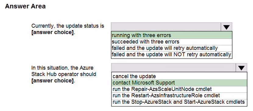

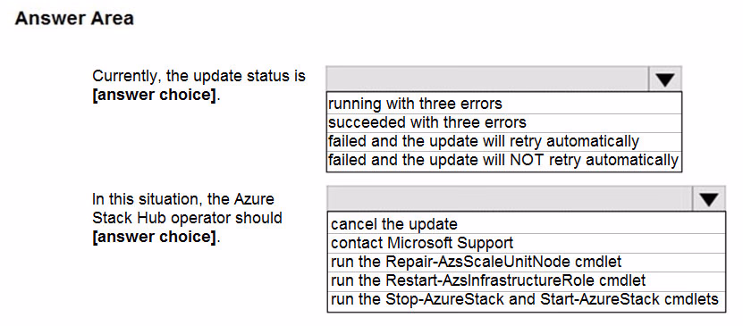

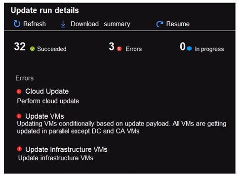

You start the update of an Azure Stack Hub integrated system. The Update run details are shown in the following exhibit.

Section 1: Running with 3 errors Section 2: Process of elimination... Cannot "cancel the update" Should never run Repair-AzsScaleUnitNode during an update Should not Stop and Start-AzureStack as this restarts all roles and nodes. Restart-AzsInfrastrucureRole would not resolve errors. Thinking it does need to lean toward contacting MS support. https://docs.microsoft.com/en-us/azure-stack/operator/azure-stack-troubleshooting?view=azs-2008#troubleshoot-azure-stack-hub-updates
d0bermannn
Oct 28, 2021
looks correct
d0bermannn
Oct 31, 2021
but..after considering 4->2 must be more correct)
