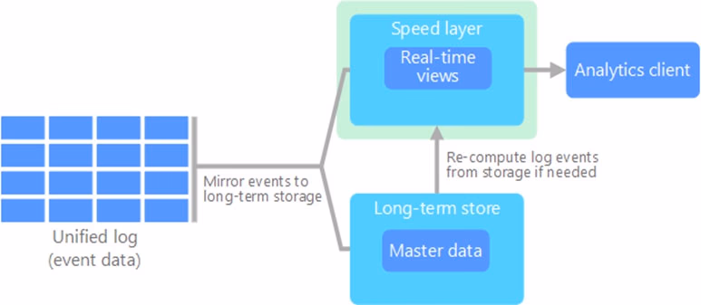

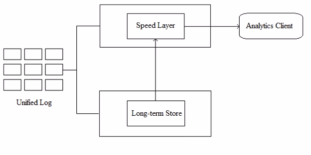

You are planning a design pattern based on the Kappa architecture as shown in the exhibit.
Exam DP-201 Question 51

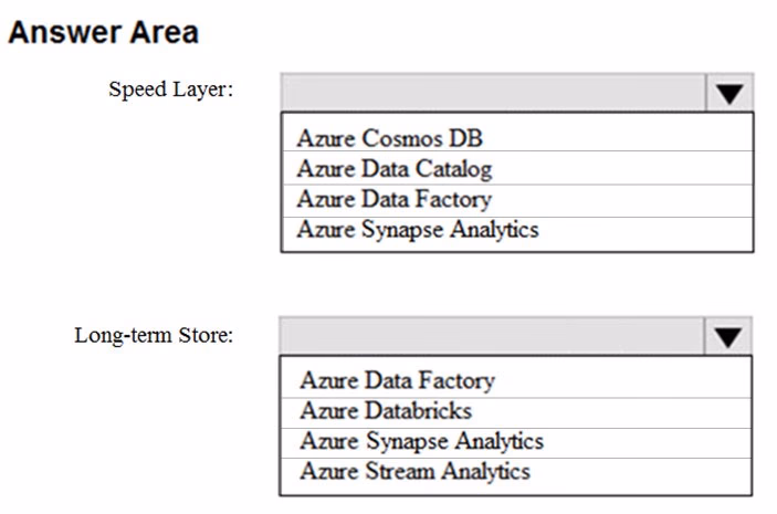

Which Azure service should you use for each layer? To answer, select the appropriate options in the answer area.

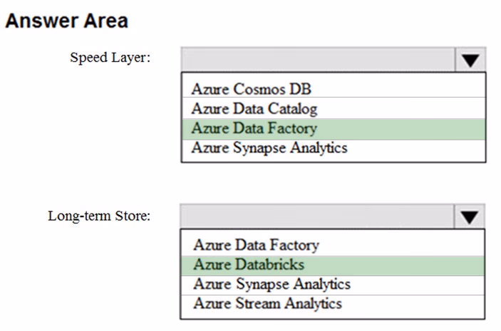

Layer 1: Azure Data Factory -
Layer 2: Azure Databricks -
Azure Databricks is fully integrated with Azure Data Factory .
https://docs.microsoft.com/en-us/azure/architecture/data-guide/big-data/
