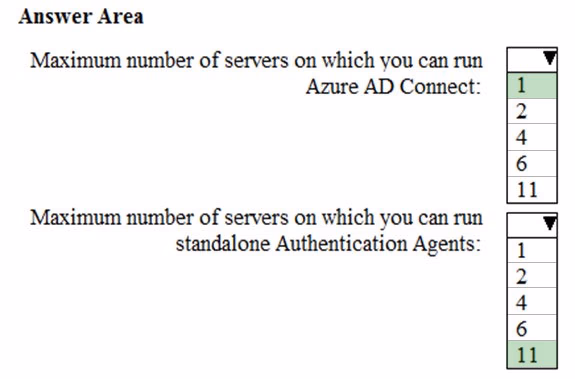

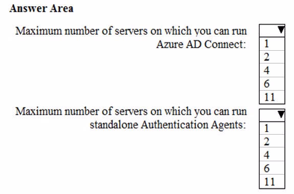

Your company has offices in several cities and 100,000 users.
The network contains an Active Directory domain named contoso.com.
You purchase Microsoft 365 and plan to deploy several Microsoft 365 services.
You are evaluating the implementation of pass-through authentication and seamless SSO. Azure AD Connect will NOT be in staging mode.
You need to identify the redundancy limits for the planned implementation.
What should you identify? To answer, select the appropriate options in the answer area.
Exam MS-100 Question 195
Azure AD Connect can be active on only one server. You can install Azure AD Connect on another server for redundancy but the additional installation would need to be in Staging mode. An Azure AD connect installation in Staging mode is configured and ready to go but it needs to be manually switched to Active to perform directory synchronization.
Azure authentication agents can be installed on as many servers as you like.
https://docs.microsoft.com/en-us/azure/active-directory/hybrid/how-to-connect-pta-quick-start
