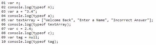

You need to evaluate the following code segment. Line numbers are included for reference only.
Exam 98-382 Question 14

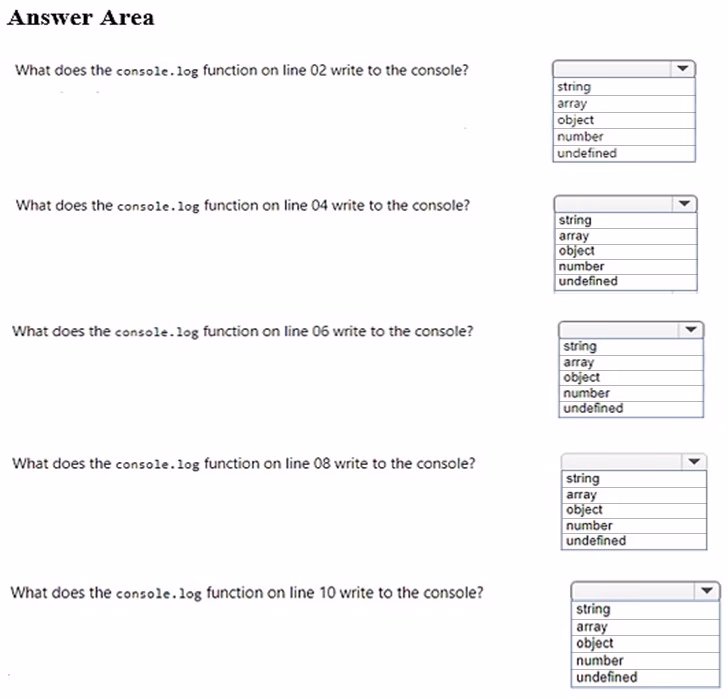

Use the drop-down menus to select the answer choice that answers each question based on the information presented in the code segment.

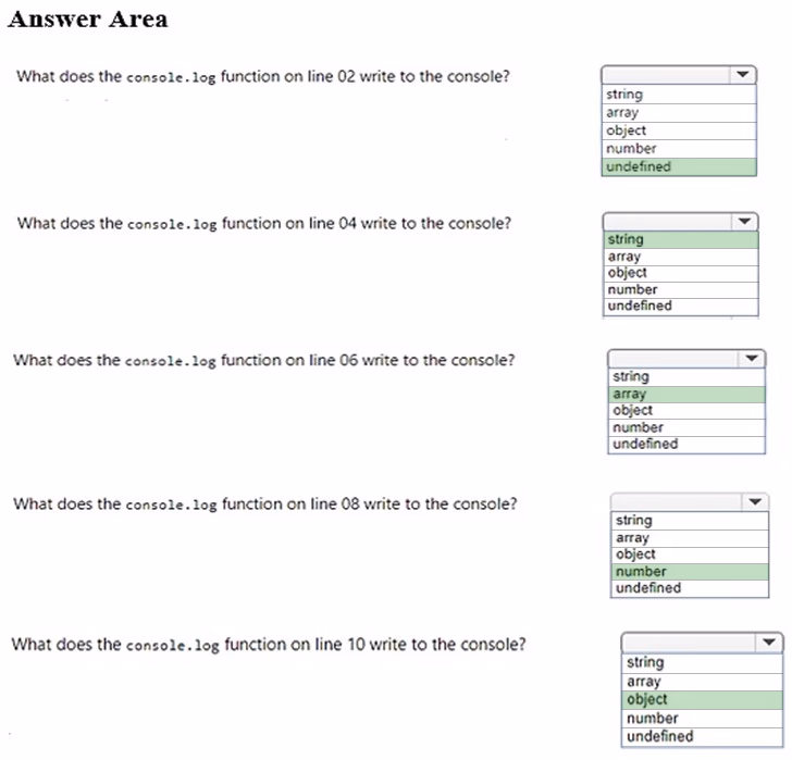

The type of an array is an object, not an array
w35l3y
Jul 4, 2021
undefined string object <-- number object
PallaviSos
Jul 4, 2021
Correct answers: undefined string object number object

123nickname123
Mar 30, 2021
I checked in the console, typeof([1,2,3]) is object, the answer is wrong
Sathya235
Jan 5, 2022
Undefined String Object Number Object
profodun
Feb 7, 2022
