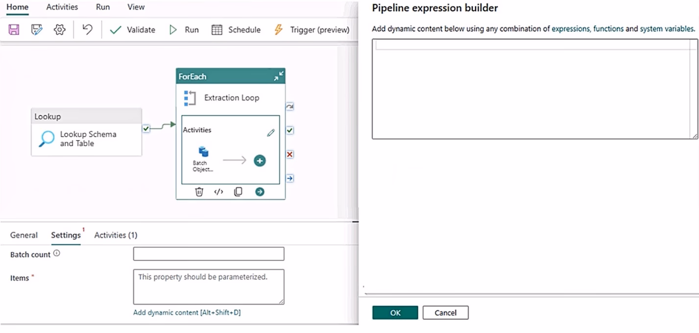

You are building a data orchestration pattern by using a Fabric data pipeline named Dynamic Data Copy as shown in the exhibit. (Click the Exhibit tab.)
Exam DP-700 Question 44
Dynamic Data Copy does NOT use parametrization.
You need to configure the ForEach activity to receive the list of tables to be copied.

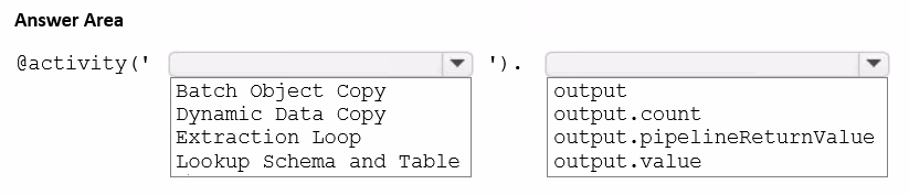

How should you complete the pipeline expression? To answer, select the appropriate options in the answer area.

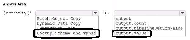

LasAnsias
Apr 16, 2025
i agree. Lookup Schema and Table output.value
acote
Apr 15, 2025
