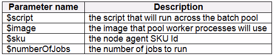

You are creating a script that will run a large workload on an Azure Batch pool. Resources will be reused and do not need to be cleaned up after use.
You have the following parameters:
Exam AZ-203 Question 8
You need to write an Azure CLI script that will create the jobs, tasks, and the pool.
In which order should you arrange the commands to develop the solution? To answer, move the appropriate commands from the list of command segments to the answer area and arrange them in the correct order.
To create a script that will run a large workload on an Azure Batch pool, the commands should be arranged in the following order: 1. Create the pool - This step will initiate the pool where the tasks will run. Use a command similar to: az batch pool create --id mypool --vm-size Standard_A1 --target-dedicated 2 --image canonical:ubuntuserver:16.04-LTS --node-agent-sku-id "batch.node.ubuntu 16.04" 2. Create the job - This command will encapsulate the tasks that will be added. Use a command similar to: az batch job create --id myjob --pool-id mypool 3. For loop to iterate through the number of tasks - This loop will be used to create multiple tasks in the job. Use a command similar to: for i in {1..$numberOfJobs} do 4. Create tasks - Add tasks to the job. This step will create the necessary tasks and make use of the loop variable. Use a command similar to: az batch task create --job-id myjob --task-id task$i --command-line "/bin/bash -c 'printenv AZ_BATCH_TASK_WORKING_DIR'" This order ensures that the pool is created first, then the job, followed by a loop to create the required number of tasks. Each task in the loop is created with a unique task ID.
