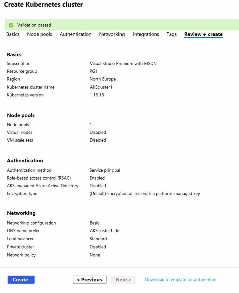

You create an Azure Kubernetes Service (AKS) cluster that uses B2s node size. The cluster configured as shown in the exhibit. (Click the Exhibit tab.)
Exam AZ-303 Question 135
You deploy a containerized application named App1 to the agentPool node pool in AKScluster1.
You need to create a containerized application named App2 that runs on four nodes of size DS3 v2.
What should you do first?
To run App2 on nodes of size DS3 v2 while retaining App1 on its current configuration, you need to create a new node pool with the desired DS3 v2 size in the existing AKS cluster. Each node pool can have a different VM size, enabling you to run different workloads with varying resource requirements. This avoids any disruption to App1 by segregating the workloads based on their specific needs.

RubberenRobbie
Jun 4, 2021
A: wrong upgrading has to do with Kubernetes version C: wrong this cluster cannot autoscale D: wrong this is for using ACI in your cluster Unfortunately B. is also WRONG. You cannot Add a node pool if scale sets are not enabled. Still B. is the best answer, but it will not work in this particular config

comment is incorrect when it comes to D. Adding virtual pods is perfectly supported and not limited to (non-Kubernetes) ACI, see ref: https://docs.microsoft.com/en-us/azure/aks/virtual-nodes
Aug 28, 2021
https://docs.microsoft.com/en-us/azure/aks/use-multiple-node-pools In Azure Kubernetes Service (AKS), nodes of the same configuration are grouped together into node pools. These node pools contain the underlying VMs that run your applications. B is correct
anupam77
Jun 19, 2021
Correct answer : B https://docs.microsoft.com/en-us/azure/aks/use-multiple-node-pools#specify-a-vm-size-for-a-node-pool
tita_tovenaar
Jul 23, 2021
We lack info to be sure while picking the right answer, as this is dependent on the initial config of App1. Alternatively we have to assume that App1 has default nodes which are DS2v2 (different from DS3v2 required by App2) I'm guessing the actual exam question has clickable sections and we only see one shot here. Having said that, bear with me: A - wrong, this is related to Kubernetes software version B - valid answer, ref. https://docs.microsoft.com/en-us/azure/aks/use-multiple-node-pools C - probably wrong as App1 and App2 (probably) have different specs D - virtual nodes are not meant for this use case, but rather to wrap Kubernetes around other services that support containers such as AWS Fargate, IoT Edge, Hyper.sh or Microsoft’s ACI

Mikeliz
Jun 9, 2021
I think A should be the answer. The created AKS runs on B2S, the App2 needs needs to run 4 nodes of size DS3 v2. This should be upgraded.
nakedSnake666
Jun 9, 2021
question leads to admit that app1 migut still run on the B machines. So, a new pool will do for app2
leo_az300
Aug 6, 2021
Answer is correct. The only tricky part is that the question should specify AKS cluster load balance SKU The AKS cluster must use the Standard SKU load balancer to use multiple node pools, the feature is not supported with Basic SKU load balancers.
