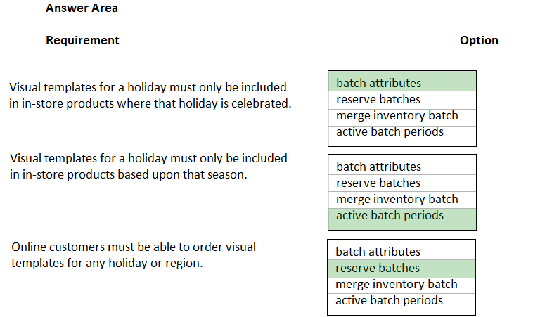

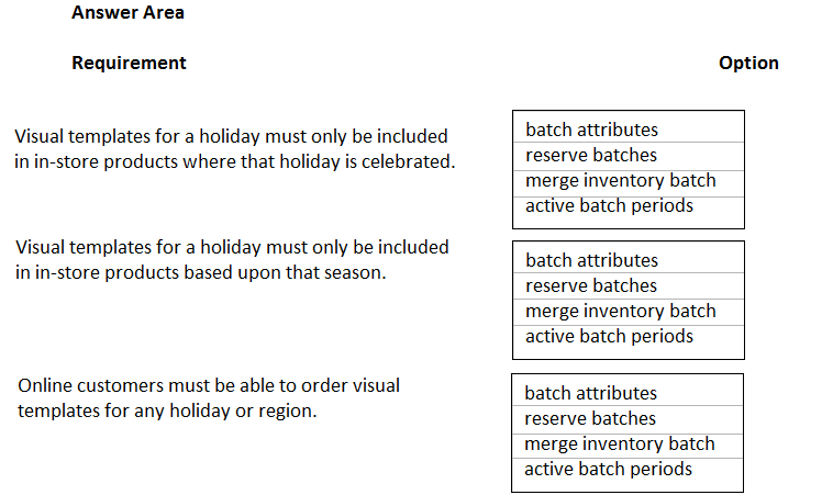

A company produces light projection toys for holiday decorations. The company plans to implement Lean manufacturing processes.
Production master data must meet the following requirements:
✑ Visual templates for a holiday must only be included for in-store products where that holiday is celebrated
Visual templates for a holiday must only be included for in-store products based upon that season
✑ Online customers must be able to order visual templates for any holiday or region.
You need to implement production master data.
What should you configure? To answer, select the appropriate options in the answer area.

https://docs.microsoft.com/en-us/dynamicsax-2012/appuser-itpro/about-batch-attributes 1. & 3. are quite clear, but what is Active Batch Period? I can't find it in AX

Active batch periods 10/25/2018 2 minutes to read With the release of Platform update 21, an additional level of control over when batch jobs execute is now available. Previously, it was only possible to schedule a batch job to execute every hour for a specified number of hours or until a given date. Administrators can now provide information for an additional active period, such as in the following scenarios: Specifying time ranges during which jobs within a batch group can start execution. Selecting to run batch jobs outside of office hours only. Setting the recurrence for anytime within the active period. For example, you administrator might select to run the batch jobs every hour, but only between the hours of 6:00 PM and 8:00 AM.

Shouldn't this be "Batch attributes" for both of the first 2?
Daichisan
Oct 26, 2021
should be correct
