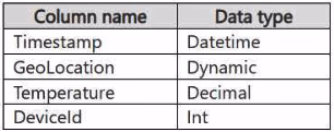

You have a KQL database that contains two tables named Stream and Reference. Stream contains streaming data in the following format.
Exam DP-700 Question 74

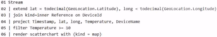

You have the following KQL queryset.
You need to reduce how long it takes to run the KQL queryset.
Solution: You change project to extend.
Does this meet the goal?
GHill1982Option: B
Jan 1, 2025
No. The `project` operator is used to select specific columns, whereas `extend` is used to add new calculated columns to the result set. They serve different purposes.
vigaroOption: B
Mar 21, 2025
more data
13d2a97Option: B
Apr 20, 2025
Changing project to extend does not improve performance of a KQL (Kusto Query Language) query — in fact, it may hurt performance or keep it the same depending on the query.
