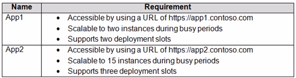

You have an Azure subscription.
You plan to deploy two Azure web apps that have the requirements shown in the following table.
Exam AZ-303 Question 236

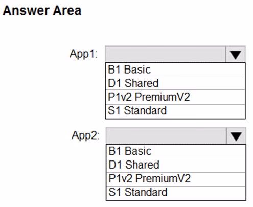

You need to select the App Service plans for the web apps. The solution must minimize costs.
Which App Service plan should you select for each web app? To answer, select the appropriate options in the answer area.

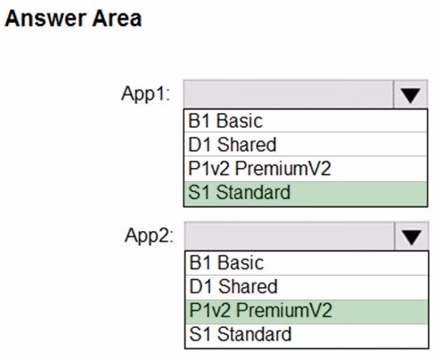

Given answer is correct.
Sumbasa
Jan 5, 2021
Given answer is correct. https://docs.microsoft.com/en-us/azure/azure-resource-manager/management/azure-subscription-service-limits#app-service-limits

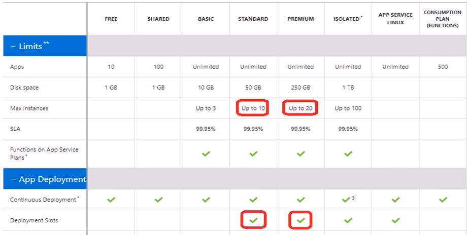

Answer #1 should be "B1 Basic", as App1 only need 2 instance while Basic appSvc plan supports 3 instance already.
SyntaxError
Jan 5, 2021
I disagree, the basic plan does not support deployment slots hence I believe the given answer is correct
OLO_90
Jan 22, 2021
deployment slots are missing at B1
ChrisG1454
Jan 9, 2022
Azure App Service plan overview "When you want to have staging environments, scale up to Standard tier." Reference: https://docs.microsoft.com/en-us/azure/app-service/overview-hosting-plans
ChrisG1454
Jan 9, 2022
Set up staging environments in Azure App Service " The app must be running in the Standard, Premium, or Isolated tier in order for you to enable multiple deployment slots." Reference: https://docs.microsoft.com/en-us/azure/app-service/deploy-staging-slots
ChrisG1454
Jan 9, 2022
