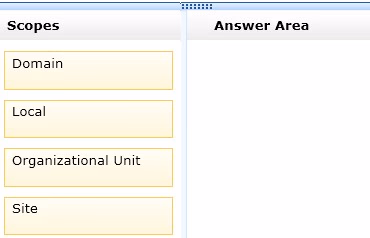

In which order are group policies applied?
(To answer, move the appropriate scopes from the list of scopes to the answer area and arrange them from first applied to last applied)
Exam 98-365 Question 6

the answer given is WRONG, this from the microsoft link it sites in the answer: Local Group Policy object--Each computer has exactly one Group Policy object that is stored locally. Site--Any Group Policy objects that have been linked to the site are processed next. Processing is synchronous and in an order that is specified by the administrator. Domain--Processing of multiple domain-linked Group Policy objects is synchronous and in an order specified by the administrator. Organizational units--Group Policy objects that are linked to the organizational unit that is a trick i learned at school LSDO, :) local, site, domain, ou

the graphic is wrong, rather, the text is correct.

they wrote out the answer at the bottom. the answer in the graphic is NOT filled out on the right

local group policy, site, domain, organizational units
