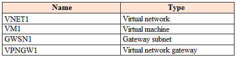

You create a new Azure subscription. You create a resource group named RG1. In RG1, you create the resources shown in the following table.
Exam AZ-303 Question 297
You need to configure an encrypted tunnel between your on-premises network and VNET1.
Which two additional resources should you create in Azure? Each correct answer presents part of the solution.
