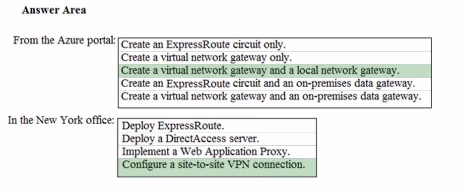

You need to meet the connection requirements for the New York office.
Exam AZ-303 Question 329
Box 1: Create a virtual network gateway and a local network gateway.

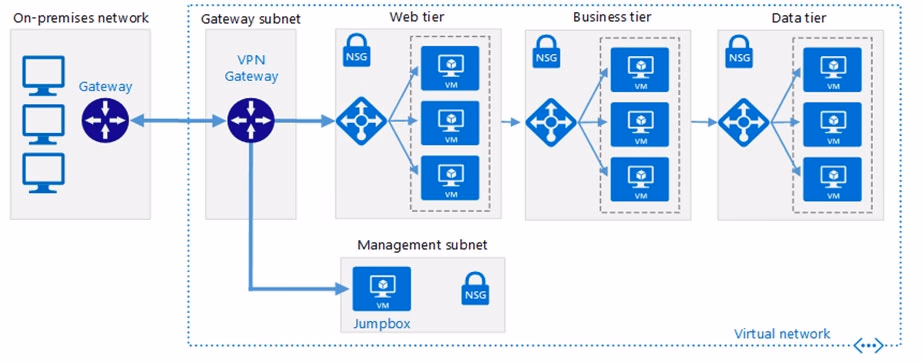

Azure VPN gateway. The VPN gateway service enables you to connect the VNet to the on-premises network through a VPN appliance. For more information, see
Connect an on-premises network to a Microsoft Azure virtual network. The VPN gateway includes the following elements:
✑ Virtual network gateway. A resource that provides a virtual VPN appliance for the VNet. It is responsible for routing traffic from the on-premises network to the
VNet.
✑ Local network gateway. An abstraction of the on-premises VPN appliance. Network traffic from the cloud application to the on-premises network is routed through this gateway.
✑ Connection. The connection has properties that specify the connection type (IPSec) and the key shared with the on-premises VPN appliance to encrypt traffic.
✑ Gateway subnet. The virtual network gateway is held in its own subnet, which is subject to various requirements, described in the Recommendations section below.
Box 2: Configure a site-to-site VPN connection
On premises create a site-to-site connection for the virtual network gateway and the local network gateway.
Scenario: Connect the New York office to VNet1 over the Internet by using an encrypted connection.

Azure ExpressRoute: Established between your network and Azure, through an ExpressRoute partner. This connection is private. Traffic does not go over the internet.
https://docs.microsoft.com/en-us/azure/architecture/reference-architectures/hybrid-networking/vpn

correct answers. https://docs.microsoft.com/de-de/learn/modules/connect-on-premises-network-with-vpn-gateway/3-exercise-prepare-azure-and-on-premises-vnets-using-azure-cli-commands
Stevezzc
Jan 24, 2021
given answer is correct.

Connect the New York office to VNet1 over the Internet by using an encrypted connection. https://docs.microsoft.com/en-us/azure/vpn-gateway/vpn-gateway-howto-site-to-site-classic-portal A Site-to-Site VPN gateway connection is used to connect your on-premises network to an Azure virtual network over an IPsec/IKE (IKEv1 or IKEv2) VPN tunnel. https://docs.microsoft.com/en-us/azure/vpn-gateway/tutorial-site-to-site-portal In this tutorial, you learn how to: Create a virtual network Create a VPN gateway Create a local network gateway Create a VPN connection Verify the connection Connect to a virtual machine Answer is correct

Answer #1 should be "Create a virtual network gateway only", local network gateway couldn't be created on Azure portal but at on-premise environment.

Create local gateway from azure: https://docs.microsoft.com/en-us/azure/vpn-gateway/tutorial-site-to-site-portal#:~:text=Location%3A%20East%20US-,From%20the%20Azure%20portal%2C%20in%20Search%20resources%2C%20services%2C%20and,Create%20local%20network%20gateway%20page.

you are wrong. The given answers are correct.

What they mean, is azure resource describing the existence of local network gateway, not the device itself. In this meaning it can be created in Azure.

Answer is correct. Since one of the requirements are: "Connect the New York office to VNet1 over the Internet by using an encrypted connection." Accordingly, the connection is VPN where Virtual networking gateway, local gateway and Site to site connection is needed.

They didn't mention that in the New york office there is a VPN gateway. "Contoso has data centers in the Montreal and Seattle offices. Each data center has a firewall that can be configured as a VPN device."
