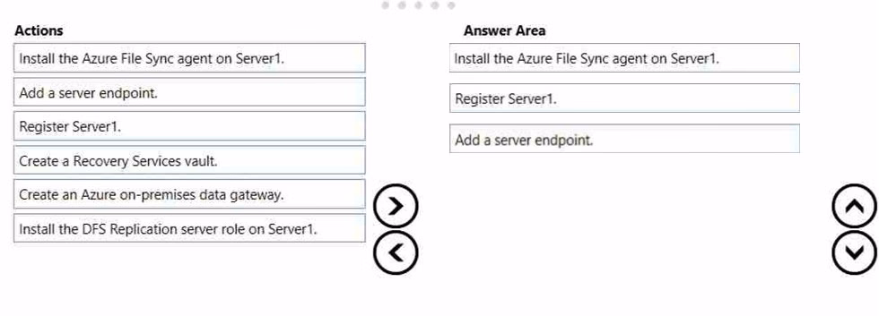

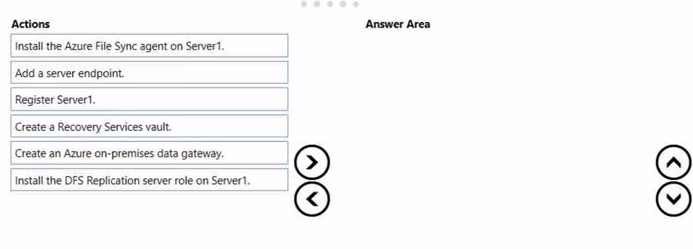

You have an on-premises file server named Server1 that runs Windows Server 2016.
You have an Azure subscription that contains an Azure file share.
You deploy an Azure File Sync Storage Sync Service, and you create a sync group.
You need to synchronize files from Server1 to Azure.
Exam AZ-303 Question 182
Step 1: Install the Azure File Sync agent on Server1
The Azure File Sync agent is a downloadable package that enables Windows Server to be synced with an Azure file share
Step 2: Register Server1.
Register Windows Server with Storage Sync Service
Registering your Windows Server with a Storage Sync Service establishes a trust relationship between your server (or cluster) and the Storage Sync Service.
Step 3: Add a server endpoint -
Create a sync group and a cloud endpoint.
A sync group defines the sync topology for a set of files. Endpoints within a sync group are kept in sync with each other. A sync group must contain one cloud endpoint, which represents an Azure file share and one or more server endpoints. A server endpoint represents a path on registered server.
https://docs.microsoft.com/en-us/azure/storage/files/storage-sync-files-deployment-guide

given answer is correct as per link mention in justification Deploy a Storage Sync Service. -already done Create a sync group.-already done Install Azure File Sync agent on the server with the full data set. 1st action in sequence Register that server and create a server endpoint on the share. 2nd and 3rd action in sequence Let sync do the full upload to the Azure file share (cloud endpoint). After the initial upload is complete, install Azure File Sync agent on each of the remaining servers.
Aug 28, 2021
Step 1: Install the Azure File Sync agent on Server1 The Azure File Sync agent is a downloadable package that enables Windows Server to be synced with an Azure file share Step 2: Register Server1. Register Windows Server with Storage Sync Service Registering your Windows Server with a Storage Sync Service establishes a trust relationship between your server (or cluster) and the Storage Sync Service. Step 3: Create a sync group and a cloud endpoint. A sync group defines the sync topology for a set of files. Endpoints within a sync group are kept in sync with each other. A sync group must contain one cloud endpoint, which represents an Azure file share and one or more server endpoints. A server endpoint represents a path on registered server. https://docs.microsoft.com/en-us/azure/storage/files/storage-sync-files-deployment-guide
