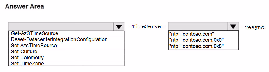

You have an Azure Stack Hub integrated system.
You need to update the integrated system to use a non-Windows NTP service that has a host name of ntp1.contoso.com.
How should you complete the command? To answer, select the appropriate options in the answer area.

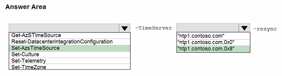

Correct answer. Set-AzsTimeSource -TimeServer "NEWTIMESERVERIP,0x8" -resync https://docs.microsoft.com/en-us/azure-stack/operator/azure-stack-configure-time?view=azs-2108#configure-time
d0bermannn
Oct 24, 2021
Set-AzsTimeSource -TimeServer "NEWTIMESERVERIP,0x8" -resync option looks correct
