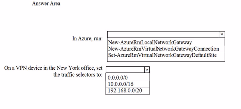

Your company has offices in New York and Los Angeles.
You have an Azure subscription that contains an Azure virtual network named VNet1. Each office has a site-to-site VPN connection to VNet1.

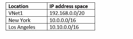

Each network uses the address spaces shown in the following table:
Exam AZ-303 Question 286
You need to ensure that all Internet-bound traffic from VNet1 is routed through the New York office.

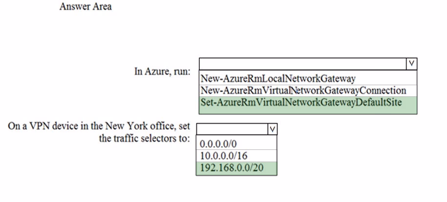

Correct Answers are: In Azure, run: Set-AzureRmVirtualNetworkGatewayDefaultSite On a VPN device in the NY office, set the traffic selectors to: 0.0.0.0/0 Forced tunneling must be associated with a VNet that has a route-based VPN gateway. You need to set a "default site" among the cross-premises local sites connected to the virtual network. *Also, the on-premises VPN device must be configured using 0.0.0.0/0 as traffic selectors.* https://docs.microsoft.com/en-us/azure/vpn-gateway/vpn-gateway-forced-tunneling-rm

https://docs.microsoft.com/en-us/azure/vpn-gateway/vpn-gateway-forced-tunneling-rm Also, the on-premises VPN device must be configured using 0.0.0.0/0 as traffic selectors. The -GatewayDefaultSite is the cmdlet parameter that allows the forced routing configuration to work, so take care to configure this setting properly. Set-AzureRmVirtualNetworkGatewayDefaultSite 0.0.0.0/0
