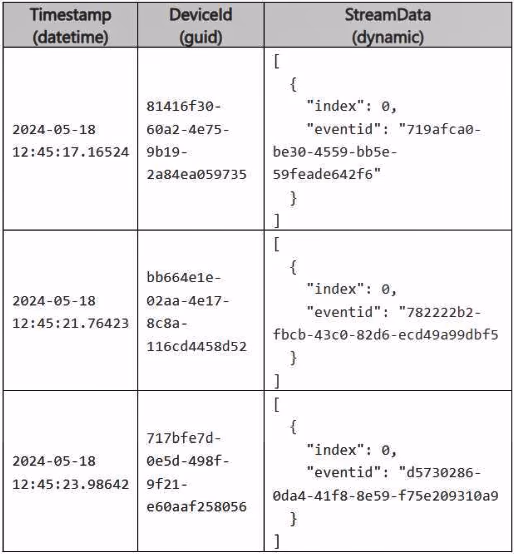

The following is a sample of the data in Table2.
Exam DP-700 Question 70

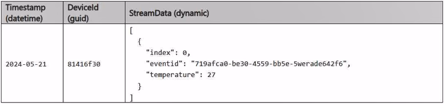

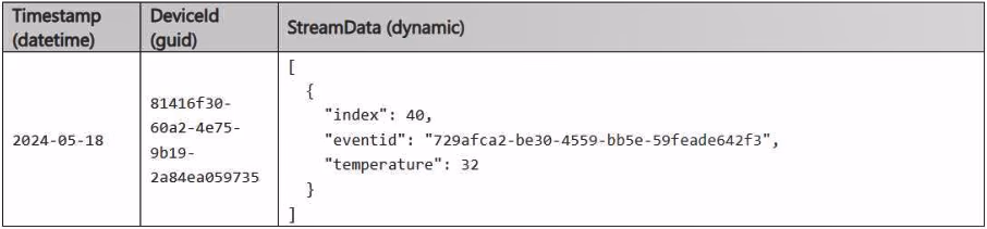

prabhjotOptions: AD
Feb 7, 2025
A and D have valid GUIds

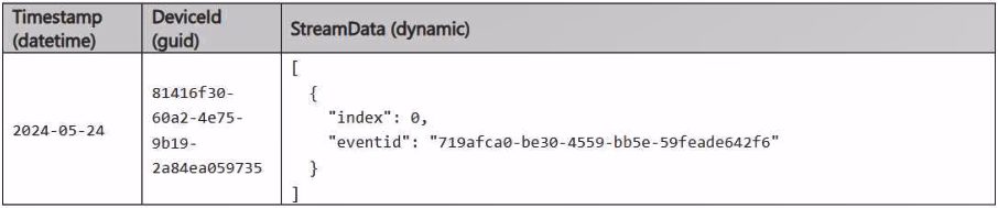

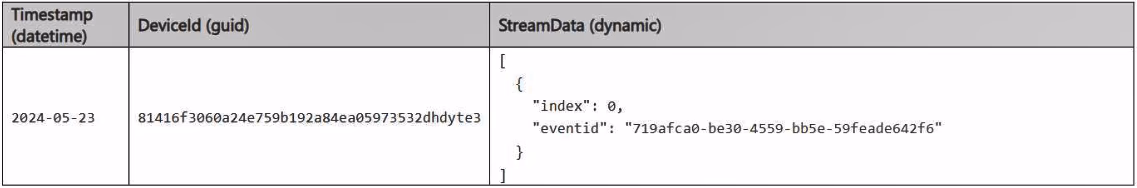

Record B loads because it conforms to the updated schema (string DeviceId, StreamData with temperature). Record D loads because it conforms to the original schema (guid DeviceId, no temperature in StreamData).
PetJoh422
Feb 13, 2025
This is incorrect because it was only updated in Table 1. So passing a string to table2 which requires a GUID will fail when it is not a valid guid.
18e18d0Options: AD
Jan 31, 2025
Records B and C will not load because of invalid GUIDs
GolearnOptions: AD
Feb 3, 2025
A & C have valid GUIds in correct format and also have temperature column
Golearn
Feb 4, 2025
A & D have valid GUIds
DirectX
Feb 26, 2025
B and D. Because of GUID fields in the source data - The destination table schema has not been changed. The third field with json data is probably of type nvarchar(max) which can accommodate any json structure.
DirectX
Mar 4, 2025
I meant A and D. Answers with valid GUID
