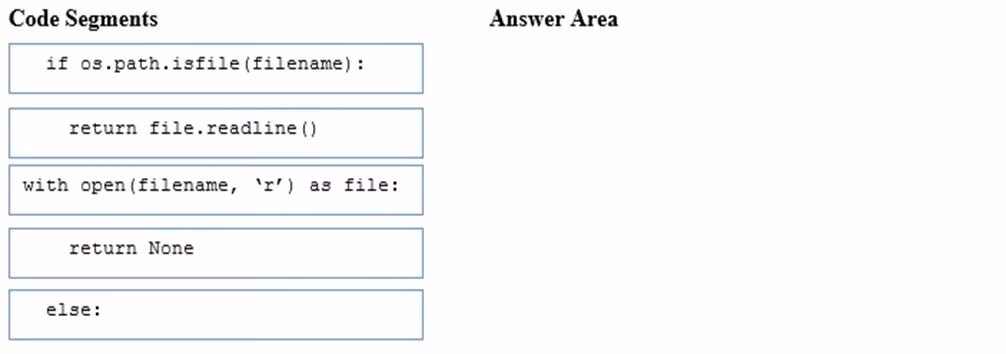

You are writing a function that works with files.
You need to ensure that the function returns None if the file does not exist. If the file does exist, the function must return the first line.
You write the following code:
Exam 98-381 Question 27
In which order should you arrange the code segments to complete the function? To answer, move all code segments from the list of code segments to the answer area and arrange them in the correct order.

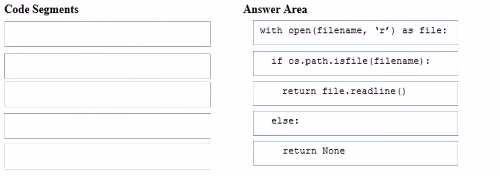

I would think the with and if statement should be swapped. If statement should come first and with statement nested in the if block

True, Question also mentions if file exist

import os filename = "ExampleFile.csv" def get_first_line(filename): if os.path.isfile(filename): with open(filename, 'r') as file: return file.readline() else: return None print(get_first_line(filename))

I got a text file named 'test_file.txt' ready to be read. Checking the two options: # Option 1: Results in error import os def get_first_line(filename, mode): with open(filename, 'r') as file: if os.path.isfile(filename): return file.readline() else: return print(get_first_line("test.txt", 'r')) # Option 2: Reads first line import os def get_first_line(filename, mode): if os.path.isfile(filename): with open(filename, 'r') as file: return file.readline() else: pass print(get_first_line("test_file.txt", 'r'))

import os def get_data(filename,mode): if os.path.isfile(filename): with open(filename,'r') as file: return file.readline() else: return None

i think it's correct too, when we put "with" befor the "if"

The "if" statement should come before "with" statement, otherwise the code will throw runtime error "FileNotFoundError" if it couldn't find the specified file in "with" statement.
