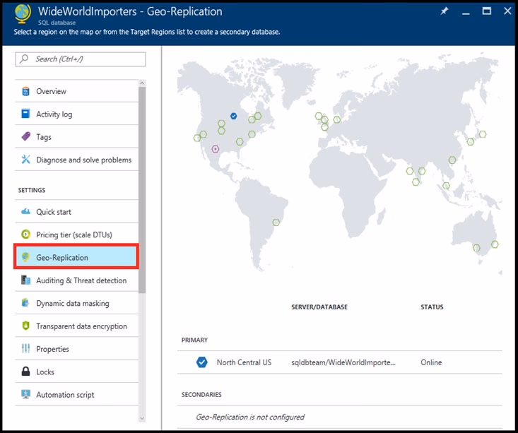

1. In the Azure portal, browse to the database that you want to set up for geo-replication.
2. On the SQL database page, select geo-replication, and then select the region to create the secondary database.

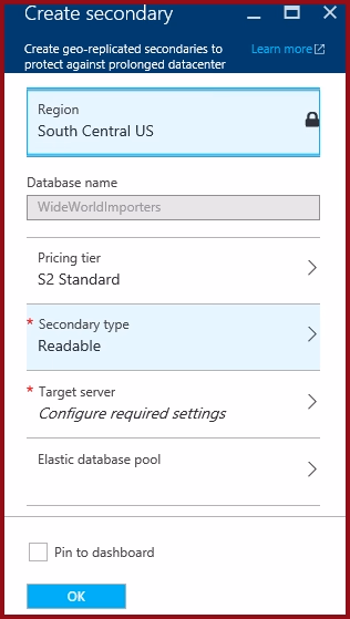

Exam DP-200 Question 36
3. Select or configure the server and for the secondary database.
Region: Central Canada -
Target server: REPL10277521 -

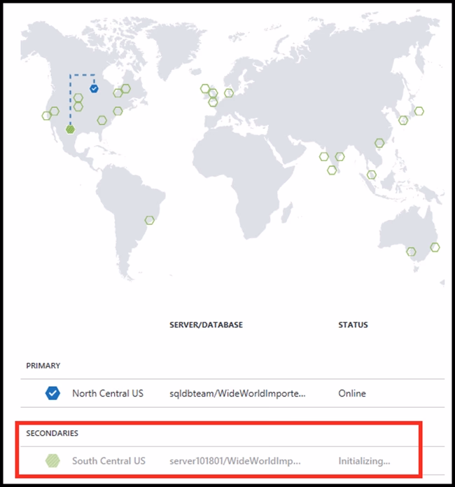

4. Click Create to add the secondary.
5. The secondary database is created and the seeding process begins.

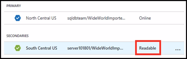

6. When the seeding process is complete, the secondary database displays its status.

In the solution, it is showing, South Central US, shouldn't it be Canada Central ?
memo43
May 16, 2021
Yes, the showing is wrong. but the explanation is TRUE
