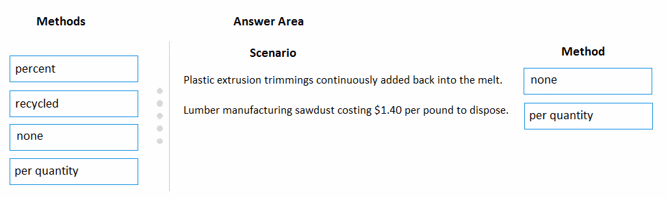

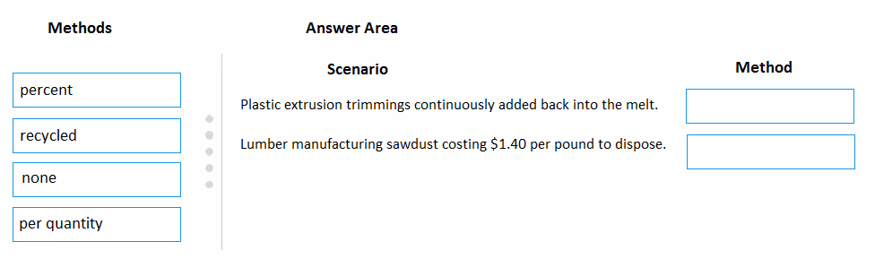

A process manufacturing company is implementing Dynamics 365 Supply Chain Management. The company will use multiple process manufacturing functionalities including by-products..
You need to configure by-product formula allocation methods.
Which methods should you use? To answer, drag the appropriate by-product burden allocation methods to the correct scenarios. Each method may be used once, more than once, or not at all. You may need to drag the split bar between panes or scroll to view content.

The second answer is Recycled. Recycling will cost another 1.40 $ of the production order so it will increase the overall cost of the production.
